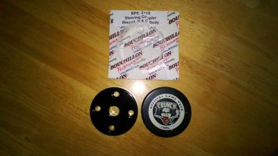

Also for the record, the Bouchillion part is EXACTLY the same size as a regulation hockey puck.
Hmm, might have to go pick up a hockey puck after work and see what I can do...

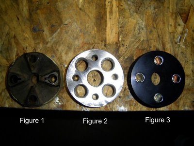

Just migrate over to what Flaming River has to offer, I did for my 70 300, same issue, solved it with 2 U Joints and a connector shaft, no more Rag Joint!
Or, you could go the hockey puck route, or like I did make one out of steel stock, cost was under 40 bucks, and the hockey puck one was under 8 bucks. The steel one is actually installed in the car now. didn't want to use the hockey puck because of the proximity to the headers!

I just made one out of a hockey puck today, I bought an orange one that's supposed to be more dense so hopefully it handles the heat. Gonna try mounting it today and I'll post pictures! Do you think it's necessary to install steel sleeves inside of it or should it be okay putting the bolts directly through the rubber?
I did the steel sleeves in the puck just because it gives a better surface to torque the bolts to and also less play possible as well as less chance of the bolts wearing the inside of the holes.

Very easy to drill, just go slow so you don't melt the rubber.
I used a spade or paddle type bit to drill out the holes.

I would be interested to see what is inside the Bouchillion part.
