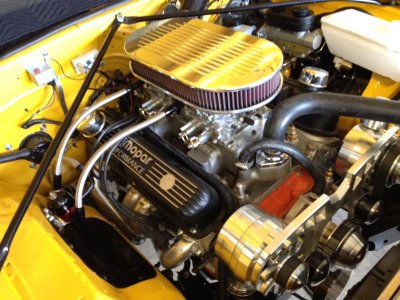

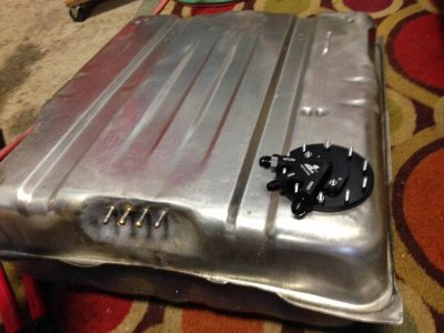

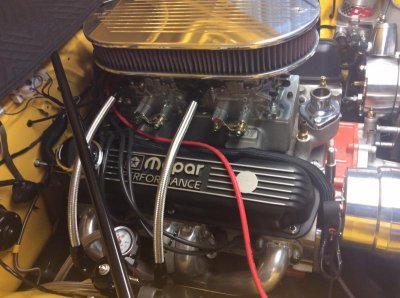

i just installed an Aeromotive Stealth 340 Phantom in tank fuel pump kit in my Roadrunner. It turns your stock fuel tank into an in tank, Sumped system. It can be plumbed as a return or non return system and is designed for continuous use and good for 1000hp carbureted and 850hp EFI and is DEAD QUIET. All you hear is the rush of fuel flowing through the lines back to the tank. The kit comes with everything you need except the fuel line and a 3 1/4" hole saw. Very awesome system and the Areomotive quality is second to none.

View attachment 278172View attachment 278173View attachment 278174
