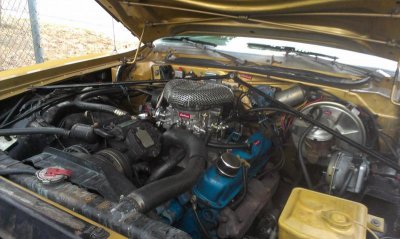

So after all my debates and research i feel i am ready to start my build. I know what im gearing for but need help deciding package to go with. FBBO has decades of well experienced mopar fans and racers so i hope this build doesnt go dead due to budget ive seen so many on. Thats why im doing motor (cheapest for me) first then body and interior as those are the most tentative and tedious for me and those im sparing no expense. My current place doesnt consist of a garage so climate and tools factorthe most in how the motor will be done.
Rather than pulling and prepping my 40 year old unrebuilt motor and getting it milled and bored etc, the heads will be pulled, maybe self ported, new valves and possibly upgrade velvetrain for bigger 2.02 valves, new cam and seals all around. Want to update any and all electrical along the way to make way for things like painless wiring kits.
i have a very good 500hp build from a very well known builder and it was on a stock stroke i beam with 318b heads with revised la bolt style.
Biggest problem with build is the extent of the porting he did, IMO was over ported but torque numbers were astounding and they used a lean burn ditsributor with 6al2 ignition. Torque was around 400 plus at just 2500 rpm! And 498 at 4800! This sold me by the sheer streetability and reliabilty of the package.... i mean who doesnt dream of a 515hp stoke stroke iron headed 360! (Actually 371)
ill find the package and link later today after work but i need to also see what needs done to my 727 to take that kind of beating... also what stall to run and differential is best. Would 355 gears be to small or should i go 4s?
it will be expensive around 3k on the cheap side put together my self, 5 if i get porting done at a shop. Trans and rear end are what will set me well passed that but this will be a slow build. I plan to run the motor for a while in between.
So here's the break down,
poor man rebuild with just top end rebuilt (after current damage inspection), new rings and everything cleaned old school... gee not that poor!
throw a cam on top of current set up on with smog heads home ported, install 355 posi or similar auburn unit and run the piss out of it at a show for fun and hopefully return a good block in a year. Then tear its guts out for the HellQueen build (i think thats gonna be her name)
After all said and done would like to strap a blower on that 500hp on that screamer but trying not to dream too big. Mainly want the reliabilty and smaller stroke the combo has so i dont ruin bearings and other horror stories i hear all the time from all these big cranks. A stock crank i rarely hear of bearing and piston failure unless running over 7k.
Sorry im so bad at writing anymore but what ever you understood give me feed back. I know these are high goals but im very tedious and patient. I want to hear motor setups and ideas as i know my set up will change as it always does. Promise to keep updated and picture worthy when work allows, and better use of grammar and writing on track (atleast when on my computer)

Heres the list
block presp; short fill water jackets, main oil feeds enlarged to 9/32 in., clevite rod bearings, eagle 4340 crank external balance, scat i_beams 6.123, kb icon pistons w perfect circle rings, arp hardware
head selection and work; 318b magnum head from enginequest w revised la bolt style, rid 8mm valves for 11/32 to open up aftermarket selection, manley severe duty intake valves 2.08 inch. Diameter and 5.250 length, cnc mill bowl to venturi shape (273cfm), T&D rockers, goal of flow is 300cfm at .600 lift
final combustion chamber measures 59cc
camshaft; custom 246/244 degree duration, aggressive intake lobes and milder HRR lobes on exhaust, intake centerline angle (102) degrees,
weiand xcelerator intake (list better ones if you know of any)
holley 750hp
lean burn distributor (has no mechanical or vaccum advance)
sxhoenfield atepped headers 1 5/8th to 1 3/4 primary
CAT crankshaft damper
billet water pump housing custom fit for moroso electric water pump
515hp w 100 octane race fuel
400lb ft at just 2500rpm and max torque at 4800rpm at 495lb ft
means really quick burn outs and a fast street car with proof hp isnt in all the parts but how wen they come together!

Im curious as to what heads i may have. I am doing a cam swap soon to liven motor up (lifters will start compressing too much making noise at low rpms after a good high rpm run or rev) so whats the deal or dispute with max lift on stock springs being .450 or .500? Which is it. I hear ppl running .520 with out issues but im going to be on long trips and stuff so i dont need anything great but i have a higher rpm setup on mine and a nice even power band so want to keep up withthat. 1mph to 45 and 55mph up my car loves from my manifold and i enjoy my power band keeping up with new magnums but i need more lift and i m not surw of my stock cam specs either. Sorry if im not explaining it right.
i was looking at this cam, (its up top as my stupid galaxy tab hates fbbo)

Its a 360. I dont mind the double spending as 1000 bucks spent twice is easier for me than saving 2k due to my life situations.
Let me re center us on subject.
1st i need my cam done.... i know cam is last but my lifters are shot so why spend 80 on lifters when i can get a cam kit for 200 plus gaskets? I like doing things just once but the next 2 years it wont be feasible as i have to help family out and school. This is a backup however it needa to move and be plated often.
next heads will be addressed. Will probably build up used iron heads.
block will be last with final cam selection. This is a very long build but i promise with weather warming up i willget on it once the sucker passes emissions.
just need a cam and lifters to feed the 600cfm carb thats too big for the motor now. Its livened up so it does ok but it needs grunt
i have a parts car lined up for 1500 with 69 x code heads. 355 gears and all that so i may get that but its states away and i have no place for another. (5 cars at my house and 2 have to be parked mile away)
sooo these next two weeks will be cam swap and head gasket since its NEVER been done before :/ by me or any owner.... think its still on original timing chain.
So for now what duration would be good for a torker single plane. I have oversized runners which helps being at high altitude and running rich but i mainly want the biggest cam my head will allow with out a higher stall converter as im not removing transmission yet. Im not worried going a little over .450 dues to 1-4 rocker geometry but i do beat on it so i wouldnt want to go overboard either so thats why i figured the one i suggested above was best but should i go with less intake or exhaust duration since my exhaust valves flow like crap on my heads if im not mistaken due to smog ports and port flow.
