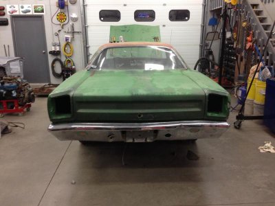

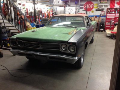

A few weeks ago I mentioned my '62 Savoy was up for sale. Well, it didn't take long to move it on. But it went in the form of a trade with a member here on FBBO. Now I have a new project in the shop. (Like I needed another!) It is special order paint 99 99 with the hood treatment and a vinyl roof. I believe Dodge called it Rally Green in '69. It is about 80% complete I'd say. It is supposed to run fairly well. I haven't tried it yet. I think it has been about three years since it was allowed to breathe fire. I'm going to do a fair amount of small repairs right away and then it will likely be a while before I complete it.

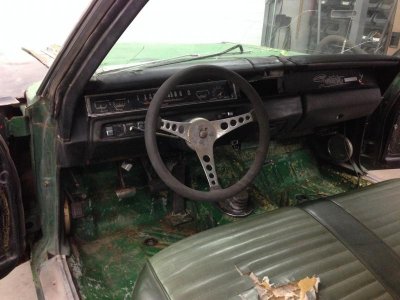

Some of the stuff it needs: trunk floor, trunk extensions, floor repair behind driver, probably quarters (may be able to save and patch the driver side), a pretty good dent in the roof, seats recovered, interior installed, driver door glass changed to post style, windshield, rot repair around front and back glass and of course a whole bunch of TLC.
Oh, and it's numbers matching! :headbang:
So without further adieu, here are some pics.

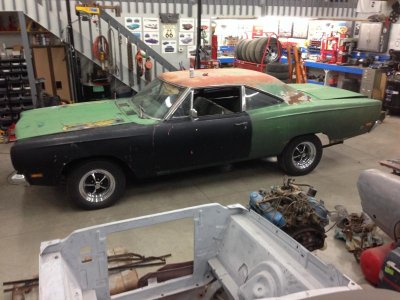

Thanx guys, I'm pretty excited about it. Well, not one to waste time I decided to get rid of that annoying dent in the roof. I built a tool to fit up in between the inner structure and the skin and got it tapped out pretty good. You can't really see it in the pic, but it was basically the only major dent on the whole car. Anyway, good enough for now.

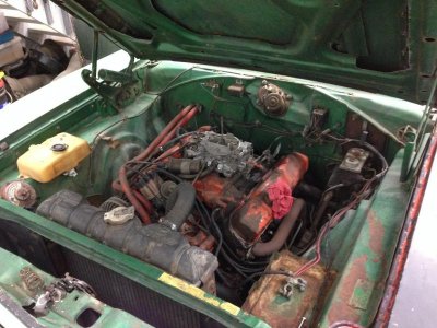

The dipstick tube was broke off at the engine mount, so I couldn't check the oil. I figured I better tackle that. Ya, that was a chore. First when I went to wiggle the remaining tube out it snapped at the block. So as I was looking at the situation I realized the driver side engine mount was swollen and could be changed. Out with the old and in with the new. I had to use an easy out to remove the little chunk of tube. What a pain. I am very happy though, the oil is brand new and the two plugs I pulled for access look new too. I think there was some servicing done just before it got parked. Then I went to the back brakes. Not so lucky there. They are toast and the driver side needs an axle seal. On another note after cleaning them up I noticed the drums still have red paint on them leading me to believe they could be original, if it came with Magnums. It's possible. The speedo read 46864 miles. I thought it was 146864, but the original looking drums make me wonder. So I blasted them up and painted them. I'll take them to my buddies tomorrow and see if they are cut-able.

Well I said it was going to run today and it did. My goal was to have it running in a week, and I made it. I didn't get to drive it around the yard but that's OK. I rigged up a little bottle with gas in the trunk, dumped a little in the carb and she roared to life. She has a throaty sound, but didn't want to idle on her own for too long. Probably bad gas still in the carb. I only ran it for a minute. The plug wires are all hanging around the headers so I'm sure they aren't in the greatest shape. A friend has a set of '69 hipo manifolds and I have a complete exhaust to the back. I think I'll change that out right away. In any case, it was a great day. She's a runner!
