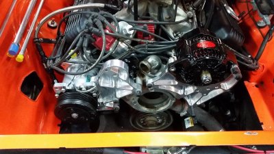

Just received my SD Concepts serpentine kit today, been busting butt on the A/C install along with dual fans and all the wiring that comes with it while waiting on the kit so now it's time to finish it off. I couldn't help but head straight to the garage for a quick test fit to prepare myselffor the agony of trying to make anything fit in front of a BB in a 69 Charger (tight is an understatement).

Here's what you get with the kit, my kit has a few extra brackets to compensate for the low deck A/C mount and for the 1 wire alt. Very nicely made and comes with all the correct fasteners.
A quick peak at the main brackets loosely bolted on.
1 minor fitment issue that's caused by me running AN fittings for the heater plumbing (a standard nipple would clear) but I'll mill this enough to clear the nut.
Here was my big concern, anybody who's ever worked on a 2nd Gen Charger knows your very limited on space. The arrow points to 1 of my 2 plans on making up the 3/4" of space I need to create, looks like trimming the fan bosses back 1/2" will push the motors in gaining 1/2".
2nd plan is to take a router to the mounting surface of the fans and gain another 1/4"-1/2"?
This weekend I'll tackle the install but for now I need to track down a few more parts.

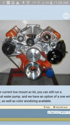

For those who haven't seen this kit yet.

Nice, I am sure you will sort it out, will look good when you do, always something that comes up when changes are made. I like the black alternator on the shiny bracket look. The 180'ish AN fittings off your water pump housing for your heater hoses, Do they end up getting hooked to the hard plumbing I see on the side of your engine bay? I intend to hard plumb a bunch of items, one of them being my heater hoses as well, right now they are over top my engine and kinda in the way.
The hard lines will get turned down the inner fender shooting the heater hoses under the A/C to keep it as clean as possible. I'll post plenty pics once I get into it.

This weekend I'm putting it on stands so I can look into the possibility of sliding the whole motor and tranny back a 1/2"? I'm really tired of the lack of space and would really like to free up as much as possible but can't remember how much wiggle room I have with the T56? Just an idea but altering the motor mount and slotting the transmission crossmember are easily done so we'll see. The big problem I've ran into everytime I looked into electric fans is in order to get the cfm's you need space, these fans put out 2,700 cfm so I chose to get the right fan and make it work one way or the other.
That was the biggest reason we haven't committed to any spacing until we could trial fit the MF front end. Now we know where everything has to go and how much room we had to play with backwards. The Charger's are worse than the RR for space up there though!
Hmmm, that's a cool idea. Would rather a direct drive but that's an option.
Yeap that pic pretty well sums up why I'm considering the motor shift, ridiculous how little room there is.

These kits look really slick black anodized. we've had people question whether its a factory option that was little known about.
