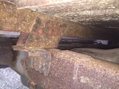

On my 69 B body I am planning to change half the rear frame rail I'm wondering what is the best way to section it together for the most strength? I am planning on sectioning it about three feet in from the back before the bend

With the rails open like that plates on the inside is good. Fully welded plates are much stronger than plug welds. Plates and caps would be fine.
Thicker steel (full) frames need to be plated because the strength is only provided by the thickness of the metal itself and the welding provides stress risers within the steel. The plates break up those risers and disperse the load around the seam. These rails are stamped steel and the strength comes from the welds and bends in the metal more so than the metal itself. If you butt weld it and duplicate all the spot welds you won't "need" the plate. You might want it, but structurally you'll be fine as the welded spot will be stronger than the metal on either side.

so you are saying as long as I do a good job welding it I don't need to add any extra reinforcement? Would putting a sleeve of the same gauge metal in it be beneficial at all?
I'm saying as long as the sheet metal you're adding is the same gage, and welded properly to ensure it's penetrated fully, and the adjoining parts are solid and the plug welds are fully penetrated, then you will not need more reinforcement in that area. That's because on a unibody chassis the chassis's strength is the sum of it's parts. That's why it's critical to get the rust out of it as a whole. It's "the sum" because the combination of bends and various spot welded connections are what causes the overall strength to be high. The stamped sheetmetal rail by itself is flimsy. But spot weld the trunk, the crossmembers, the bumper reinforcement, and the wheelhouses to it and it's damned strong.

Sectioning in parts of the uni-body is done all the time and the repairs are finished to not be apparent. As long as the section you're welding in is solid, and the pieces you're welding to are solid, and you welding (butt welds and spot welds) are good there is very little overall strength added by doubling up metal in one localized area. The way the uni-body works is the stress is dissipated throughout all the welded parts. So that rail is not carrying all the stresses day-to-day. As long as the rail and the parts connected to it are solid, the rail is transferring the stress to all the parts welded to it through it's entire length. those areas that need extra strength because they do deal with localized stress are already very thick. i.e. the leaf spring shackle areas, or the junctions of the rockers and lower cowl sides. The middle of the rail is not one of those areas.

awesome thanks for the info. I didn't really want to add more, just wanted to do it right. I am confident it will be fine with how you explained it. One last question, can I cut it straight up and down to patch it together or should I put it on an angle to get more surface area to weld?
all of the above, but have u thot about exact fit square tubing welded in side of it, after the splicing ?
I have considered that exact thing and I think it would be a problem as a square tubing will be heavier metal then what the frame rail is made of therefore I couldn't get enough heat into it to make it penetrate well. But perhaps the solution to that is to just sleave it just at the joint with the same thickness material as the frame rail but as mopar said, there is enough structure between the trunk pan and everything else that welds to the frame to make it solid without having to do that. I kind of knew that was the answer in the first place and I was planning on doing it that way with just butt welding it but I got conflicting information from people that said that that wouldn't work properly so then I had my doubts

In my quest of searching for the correct answer in preperation of a front frame splice, I became thoroughly confused because everyone seemed to have a different opinion. One constant, however, was to stay away from a 90* buttweld. When I spliced my frame I used an arrowhead cut on both pieces and I added fishplates inside which were plug welded. I shall see.
