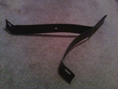

I got a bud with a plasma cutter to cut holes in my front bumper brackets. Going with glass bumper but wanted to leave some strength in the brackets.

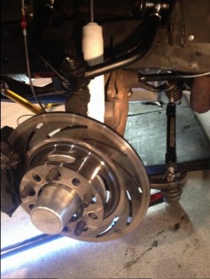

I saved well over 100 lbs dumping my old drums. Also an alumnium driveshaft.

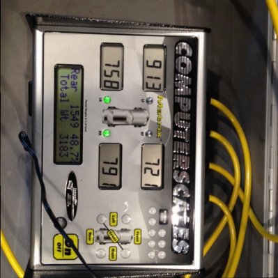

These readings show a need to add load to the right rear by at least 90lbs if the driver is in the car.

Correct this was just a pic out of my car window not the final adjustment. Prior the car adjustments launch would hook right. Now you don't need to even hold the steering wheel on launch. I will see if I have the final picture. I was just showing the weight of the car.
