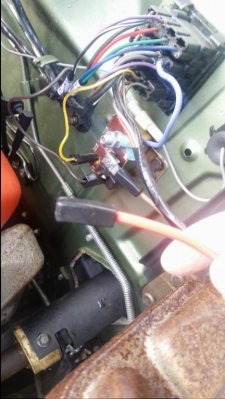

Ignore the terminal I'm holding in the foreground. What you will look for is the yellow with black tracer going from the bulkhead foreword light harness to the starter relay on the firewall.

Anyway, I touched the yellow wire and this happened.
I have the FSM. Was hard to pin point the section I needed to read.
Well that will sure keep it from cranking over! Yellow is 12v start command from ignition switch. Brown is relay coil GROUND from NSS on transmission. Both signals MUST be present at the starter relay for the starter to be engaged to crank the engine over.
Huh. Well it has always been cranking over. Lucky I touched this I guess cause it was going to come off, soon.
