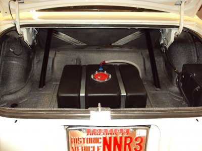

WOW you got it pretty lite. What did you do
Removed most the interior ( seats, counsel, dash, much wiring, all the HVAC, power steering, power brakes, inner fender panels, cruise control and wiper system, fuel tank for a 8 gal fuel cell, and replaced the 50 + lb front bumper with a 7.5 lb frt bumper. Probably dropped 75 lbs off the engine with aluminum heads and intake. Those were the big items I can think of. Car originally weighed 3960.
