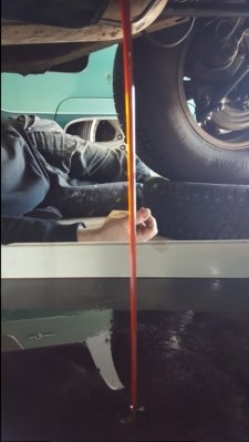

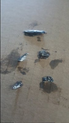

Pulled the pan today, thin metal in the pan.
20170426_184044.jpg 20170426_175528.jpg 20170426_183601.jpg 20170426_183625.jpg

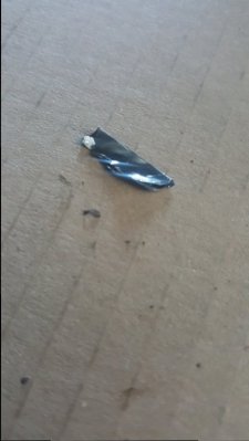

Could be a few things but I suspect planetary teeth or case. That kind of goes along with your description in the first post. Is it magnetic?
Well doesn't look like brass, time for the trans to come out. What caused it is the major question!
Looks like low roller clutch (sprag) springs. Are they barely magnetic? If so that's them. Need a close up pic. But wait until it comes apart. Like I said earlier the problem will show itself.
Doug
dvw is right, the sprag springs are quite thin metal. They're accordion shaped before getting ruined.

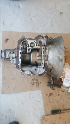

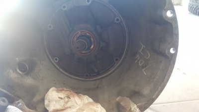

Tranny is out, what is the next step to get it apart.
