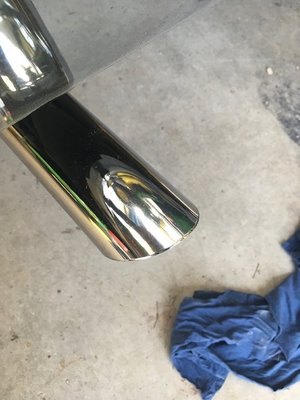

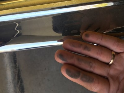

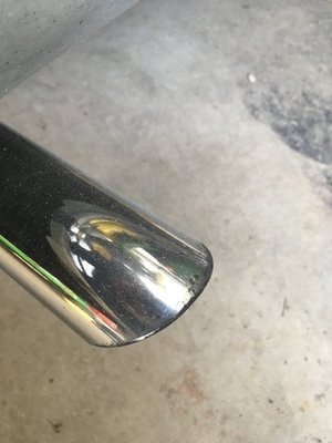

Here are some pics of the soot, although its kinda hard to see on the bumper in the picture. I wiped my hand along 6-8 inches and the tail pipes is one dirty and after wiping with a rag. I likely drove for 2 hours that day.
Are you sure that not just left over oil from before the valve stem seal change?
I have probably put 100 km or more on it since the seals were done. I guess it is possible though Mark.
