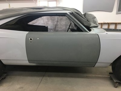

Moving sloooow here for anyone who is till following this thread but gaining a little momentum since I started this thread. In the process of mocking up the body before we weld the frame rail connectors in. I realize I probably don't need to do it but a very good friend and body shop owner suggested I do it as the car has been apart for 12 years and the body work was done in pieces. Below are pics of the passenger side. Fitting together well, at least good enough to weld the rails in. We'll tear it back apart to paint the hidden surfaces after the rails are in.

Thanks Hawk, your first pic along with a response on the other thread I started just for this cleared it all up. I only have one fastener left over now.Here are a couple of pics of my car as I tore it apart. Not sure if these help, but here they are...
