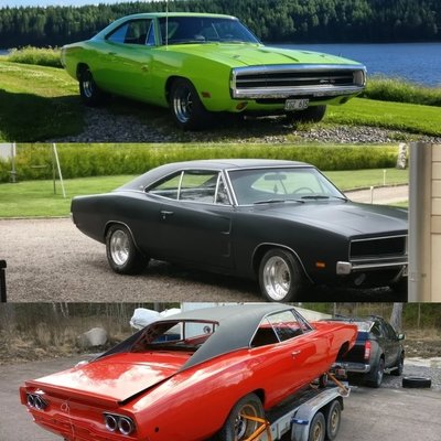

I have owned a numbers matching 1969 Charger 440HP RT/SE unrestored for many years but in pretty decent good shape. 727 auto and a 8 3/4" in the rear. I have worked on it mechanically over the years so it runs ok. New ignition parts, carburator, new interior etc. My brother laid a matte black vinyl wrap since the paint was horrible. No rust anymore though. Only rust repair needed was a patch in the lower front part of the driver side rear quarter panel and a completely new trunk floor. I believe the original paint is celled A4.
But, along came another car..

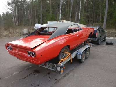

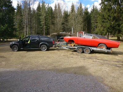

My father owned this Pro Street plum crazy 1968 Charger with a crazy Ray Barton built 528 Hemi. A buyer came along who wanted the custom built Pro Street chassi. The rear end was very modified with huge wheel wells and a 4-link ford 9". The new owners plan is to race the car and therefor use a boosted 440 engine instead. We kept the Ray Barton engine incl K-member and other accessory parts such as ignition, radiator etc. Everything needed to have it work like a charm like it did in the Pro Street -68. At the same time we found another car, a 1968 hemi-orange project car. We do not have any buildsheet nor fender tag. All we know is that it is originally a big block car with manual gearbox and manual brakes and steering. That is it.. The car was painted a long time ago, 10-15 years. So there are some paintchips and flaws here and there but we will not repaint. Only fix it so it looks decent. This will be a driver for sure. I do not have to worry about ruining the value like with the 1969 if I start modifying this thing to my liking. The car came in boxes with a LOT of parts missing. I will need help with this I believe..

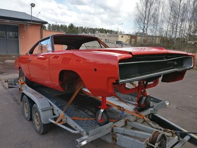

The front frame was bent and twisted quite alot. The bodyshop did a very good job with it so now we can continue with the us car tool stiffening kit which should arrive soon.. Man do I wish I lived in the US.. This hobby would have been so much easier.
You can tell from the picture that it was severely twisted. I guess this is why the guy who started the restoration some 10-15 years ago gave up. He could only fit 3 out of 4 bolts on the K-member that came with the car... A new one is now being installed.(Hemi K-member with the skidplate)

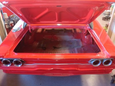

The crown-jewel has also arrived together with a refurbished A833 18-spline manual, a new hood with cutout completed(riser intake use a lot of space), Hemi K-member, headers, clutch kit from Mcleod good for 1000hp incl hydraulic clutch kit from american power train. New billet flywheel. I will just need new ARP-bolts than I will bolt everything up together with the K-member for having it installed from underneath, built a rolling stand for this. I believe it will make things easier.
