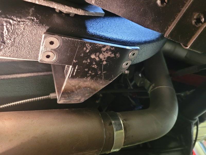

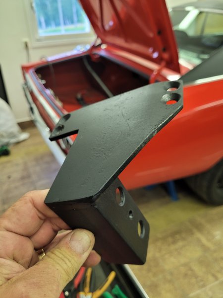

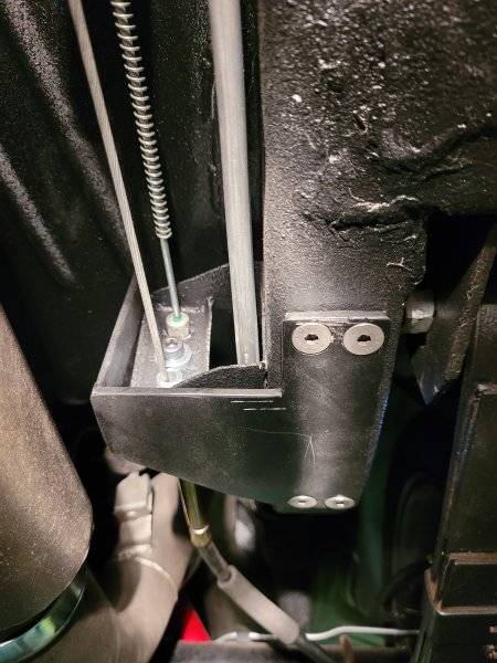

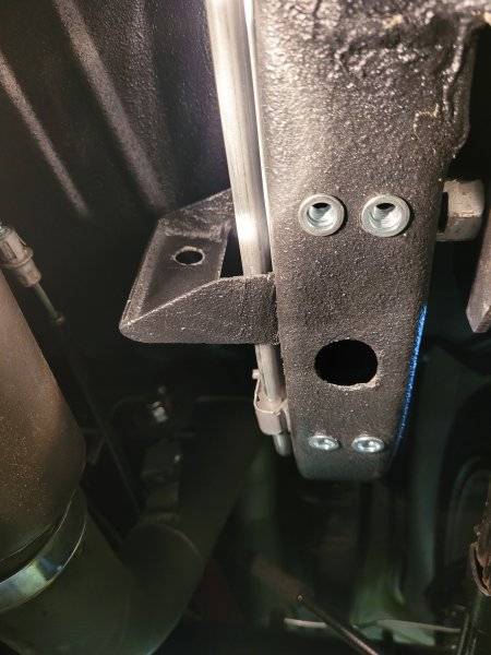

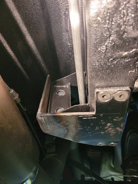

I think I sorted out the em.brake.
I contributed to this issue by myself I believe.. I wanted the fuel and brake lines neatly running along the frame rail snd raised the em.brake bracket to run lines underneath. I should have done a sturdier bracket. What I did now was a bolted support bracket. Now it's dead solid with zero flex. Much better brakes now, hope it's enough for the inspection!

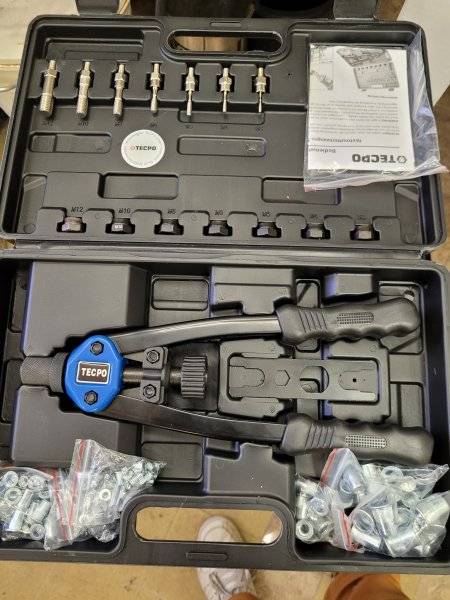

Anyhow, it gave me an excuse to buy a new tool, a popnut set!

I have a Marson. It is about my favorite tool!

Nice fabrication work! :thumbsup:
