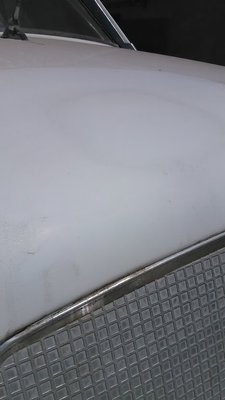

This 62 Stud Hawk was painted 35 years ago in ppg delstar acrylic enamel. It has sat outside on stands in the desert for @ least the last 10 years very unattended. btw, it is a complete turn key car.
The paint has let go some on the pot metal grille pieces, otherwise it is not checked & even still shows some gloss, it is not chalked out from oxidation. This little spot on the deck lid i just hand rubbed real quick w/ a mild compound. 2 quick applications. The gloss is coming back with not a ton of effort. I know with some color sanding with just 1500 & rubbing with wheel i could get this bastard as wet as it came out of the can.
I defy one to show me a clear that will last this long under the conditions i described. This was never a garage car, was driven & exposed to elements under average conditions until it was put on stands 10 plus years ago.
Now if it was a metalic, of course the metalics would be dust, but it would still buff. That question would be whether there was enough paint on it to not disrupt the metalic layout during sanding & rubbing & end up with mottle. The only reason clear was designed & put into use on new cars toward the end of the sixties was to protect the metalics since
they are what oxidize before the pigment does. Then the factories started to clear opaques as well in the 80's simply because it cut production costs. There is NO clear that will last this long under harsh conditions.
Unfortunately ppg discontinued delstar last year, but dupont is still making single stage centari acrylic enamel in limited colors.
I'm checking w/ sherwin williams next to see if they still mfg akrlyd single stage acrylic enamel.
The bitch is in california, acrylic enamel as well as lacquer are illegal in automotive.
When it comes time to paint my car(black), i'm going out of state to buy my materials.
Clear is a much added expense, something else to **** up in application & it wont hold out near as long. If one isn't going with a metalic color, there is no good reason to go two/three stage. Throwing a bunch of extra money @ something isn't always the best route.

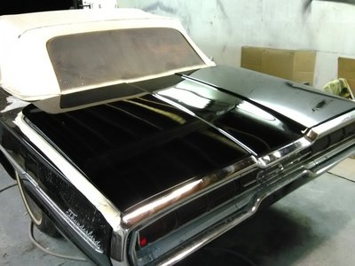

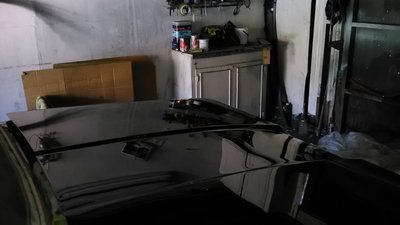

If You didn't see this before when i posted, it's 27 year old ppg delstar single stage that i color sanded & buffed...was like block sanding on a cinder block, but it came out pretty doggone flat & wet. Doesn't even have any final glaze on it yet.
