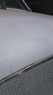

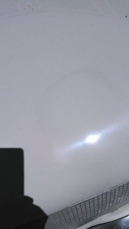

This 62 Stud Hawk was painted 35 years ago in ppg delstar acrylic enamel. It has sat outside on stands in the desert for @ least the last 10 years very unattended. btw, it is a complete turn key car.
The paint has let go some on the pot metal grille pieces, otherwise it is not checked & even still shows some gloss, it is not chalked out from oxidation. This little spot on the deck lid i just hand rubbed real quick w/ a mild compound. 2 quick applications. The gloss is coming back with not a ton of effort. I know with some color sanding with just 1500 & rubbing with wheel i could get this bastard as wet as it came out of the can.
I defy one to show me a clear that will last this long under the conditions i described. This was never a garage car, was driven & exposed to elements under average conditions until it was put on stands 10 plus years ago.

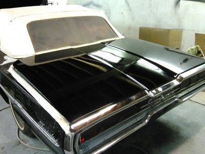

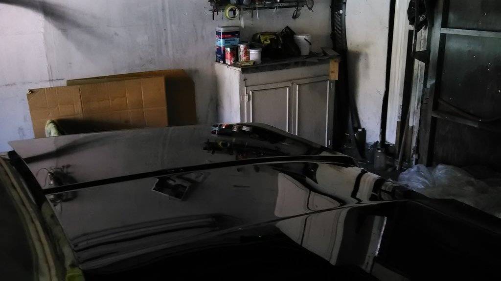

If You didn't see this before when i posted, it's 27 year old ppg delstar single stage that i color sanded & buffed...was like block sanding on a cinder block, but it came out pretty doggone flat & wet. Doesn't even have any final glaze on it yet.

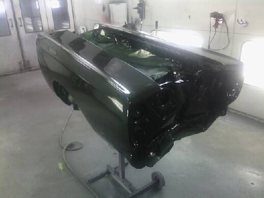

I had to get paint on the edges and in the buckets anyway, so I shot em single stage, and I like it!........ the factory look is cool! I'm sick of the glass look
Single stage is what came on them. That's normally what looks correct. I've seen bccc on a lot of classic cars and on some it looks ok. Sometimes I think it's the color that makes the difference.

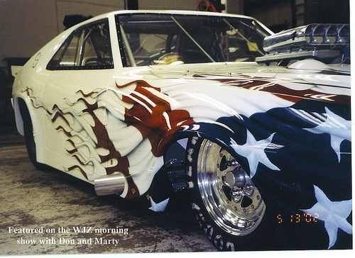

I had to learn quick about buffing. My son and I opened a custom art shop, clearing over his artwork and making sure it was right. The customers would be admiring his art for about five minutes then notice the finish. That's what you wanted. Multiple layers of art, useing innercoat clear when the windows got close, flat sanding without disturbing the art, then applying more clear for the final making sure you had enough to do the sanding and buffing. You figure out what works and what doesn't really quick. I would do all of his "bitch" work and let him concentrate on his art. Fun stuff!
One of my favs

I remember seeing this posted elsewhere a while ago,,,,very pretty scheme. Yeah, working over graphix is a tennuous bitch trying to flatten & bury all the edges without breaking the clear. What, no hazard pay?! :)

Yes, I've posted it before, bragging about the sons work! "That's my Son"!
