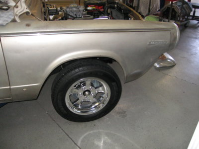

On my 65 I have SSBC disc's on all 4 wheels. Installed back in 2003. Non power and stops very well. My 2 cents.

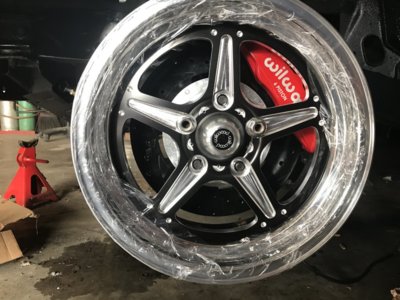

With wilwood you just have to check caliper clearance with 15” wheels.
15” wheel with 12.19” rotor and 4 piston caliper clears by a c*** hair

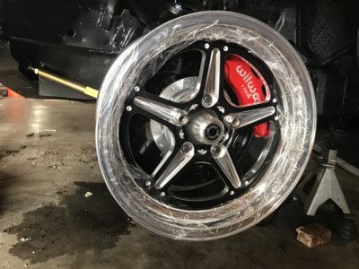

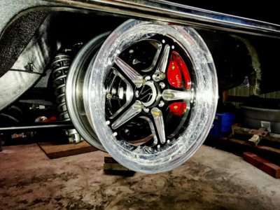

The small wilwoods still rubbed the backside of the 15x7 and 15x8 aftermarket magnums on both my charger and gtx. I ended up using a 1/8 spacer on both. This is the front caliper
Car nut I have 4 wilwoods kits here and one on the car I notice they have started to include wheel spacer for this very reason. I'm away from the shop for a few but I'll send pics when I can
Do you remember how thick the spacer is?

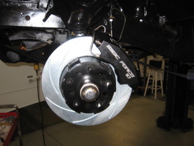

I did SSBC on a 64 Dart.Big Bolt Pattern had to use 1/8'' spacers to clear aftermarket aluminum slot 15'' rims.
I had a set of 15x7 I mocked up on my front wheels I had 12.19” rotor and 6 piston caliper and I needed a 1/2” spacer to clear the big caliper.
