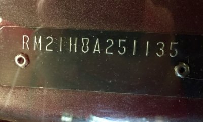

If they used flat head screws on the fender tag and also swapped the vin tag, I highly doubt they took the time to get the correct rosette rivets. Check those and it will be easy to tell if the vin was swapped as well, unless they swapped the whole dash.
Photo example of Roadrunner Vin Tag with rosette rivets.

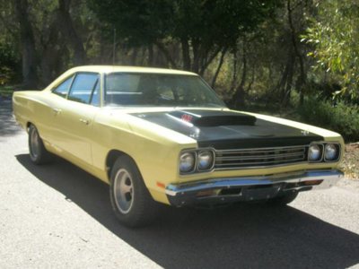

The car does look pretty sweet, and would seem to be a good deal with us having left it at $25,000 cash provided I'm happy with things. Once I sort out the details of the car, I plan to decide whether to make the long trip. A friend of a friend, who's restored a couple of classic Mopar's, thought it was a good price without being unrealistic. Attached is a photo of the '69 BB in question.

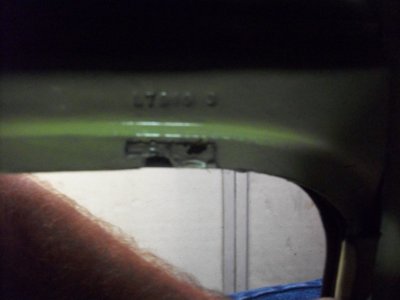

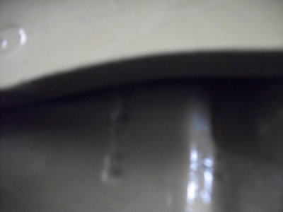

I got sirens and alarms going off right now.
Should there be other numbers stamped into the sheet metal, and should they match the VIN?
Suppose he's being open about the numbers, because they don't match anything on the VIN or fender tag. Given the attached photos, does it look like they're of the right spots?
Upper radiator core support
Driver's side trunk lip
Well......looks like your still hunting....that one smells fishy...
