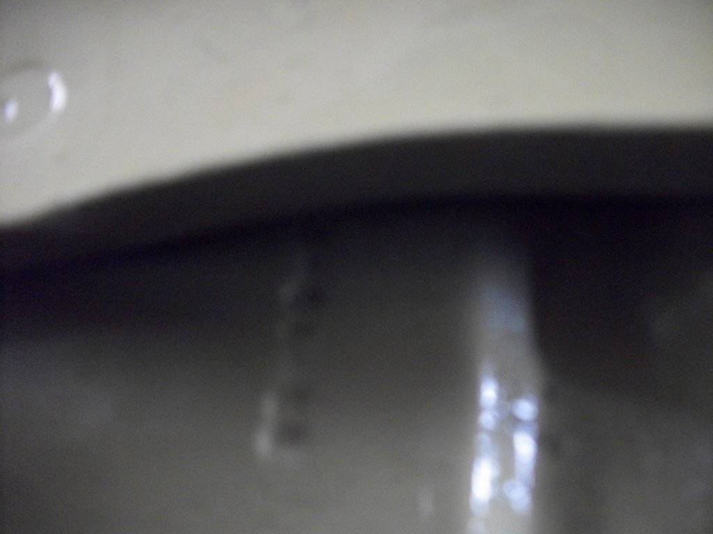

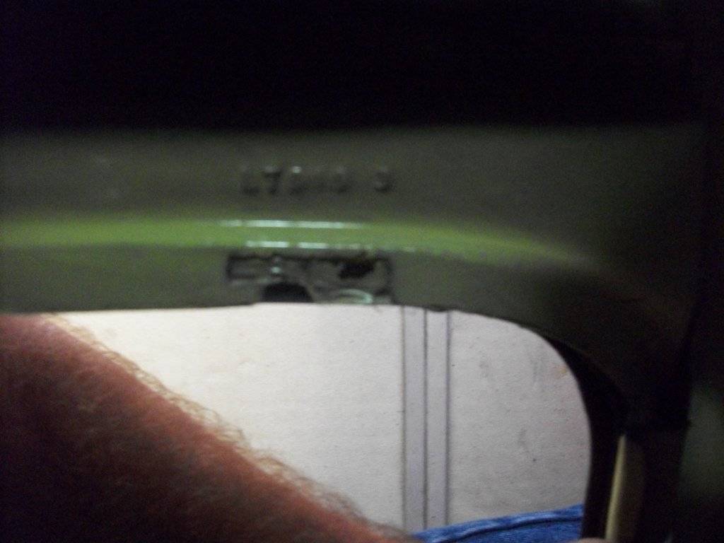

Suppose he's being open about the numbers, because they don't match anything on the VIN or fender tag. Given the attached photos, does it look like they're of the right spots?
Upper radiator core support
Driver's side trunk lip
View attachment 522706 View attachment 522708
The cat is outta the bag....radiator support/cowl and trunk rail are the top secret locations! They also added them to engines and trannies.I have heard that police officers working auto-theft and some DMV employees do searches on vehicles with "hidden" VIN numbers. I wonder if these are the same two we are talking about on the radiator support and trunk weatherstrip? I always pictured these "hidden" VIN numbers inside the frame or some other really obscure places.
