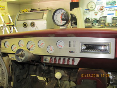

Here's a pic of what I'm doing. AutoMeter gauges, AC vents, radio and a modified glove box are the basic changes. The glove box was narrowed 4" to make room for an AC vent on the passenger's side, a modern radio with rectangular AC vents above it and another round AC vent on the driver's side. The ash tray has also been deleted and the AC controls will go there. All the holes have now been cut and fitted and all the finish body work has been done. Final paint was this morning and with a quick cut & buff it will be ready to go in the car. I'll post pics once the paint is dry enough to stick the gauges and vents in. I also filled all the dash pad holes so I wouldn't have to spend $$$ for a new one.

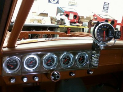

On my 65 AFX car I used autometer gauges , 6 toggle switches with red covers , moved the ign. switch over 1 inch to fit the switches in place . moved the light switch down with the others , A metal edge was welded on the original dash to rotate the new one up to the drivers eye level . installed vintage air controls in the dash with a cd player for music ,
