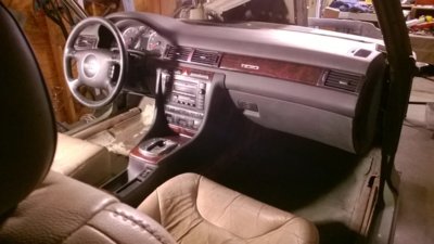

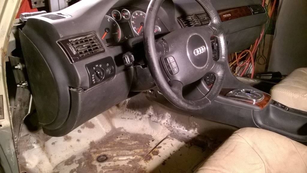

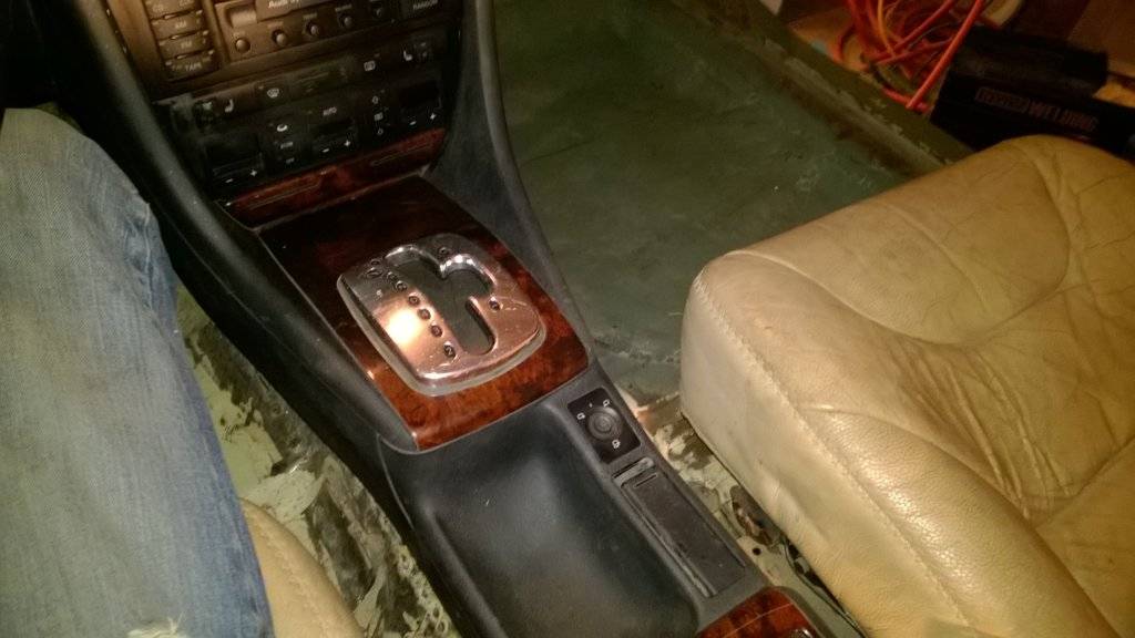

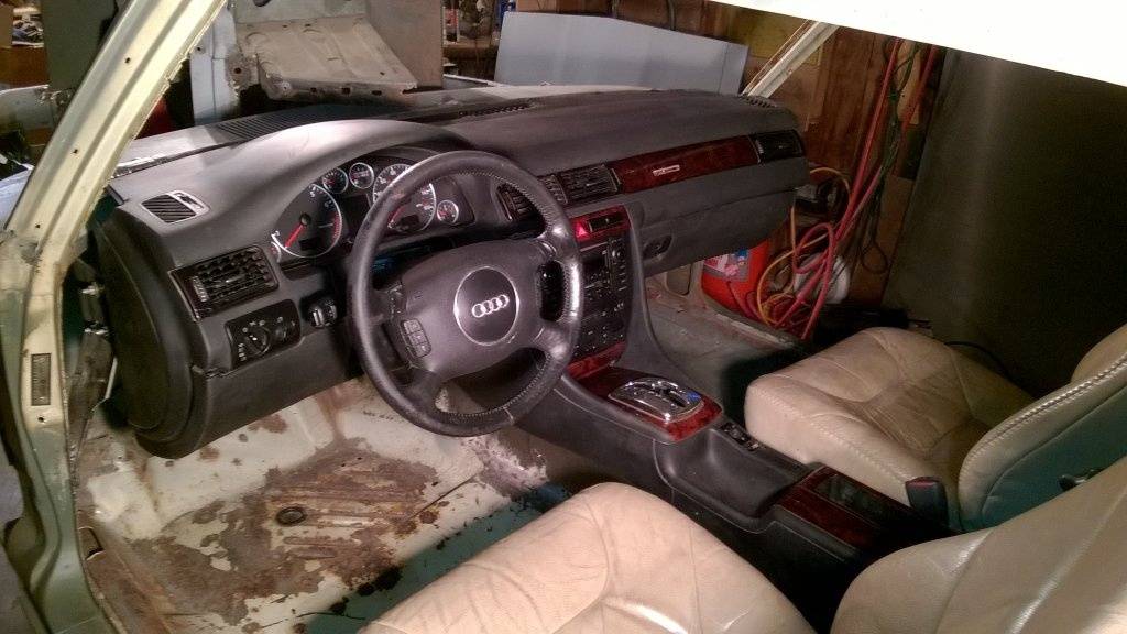

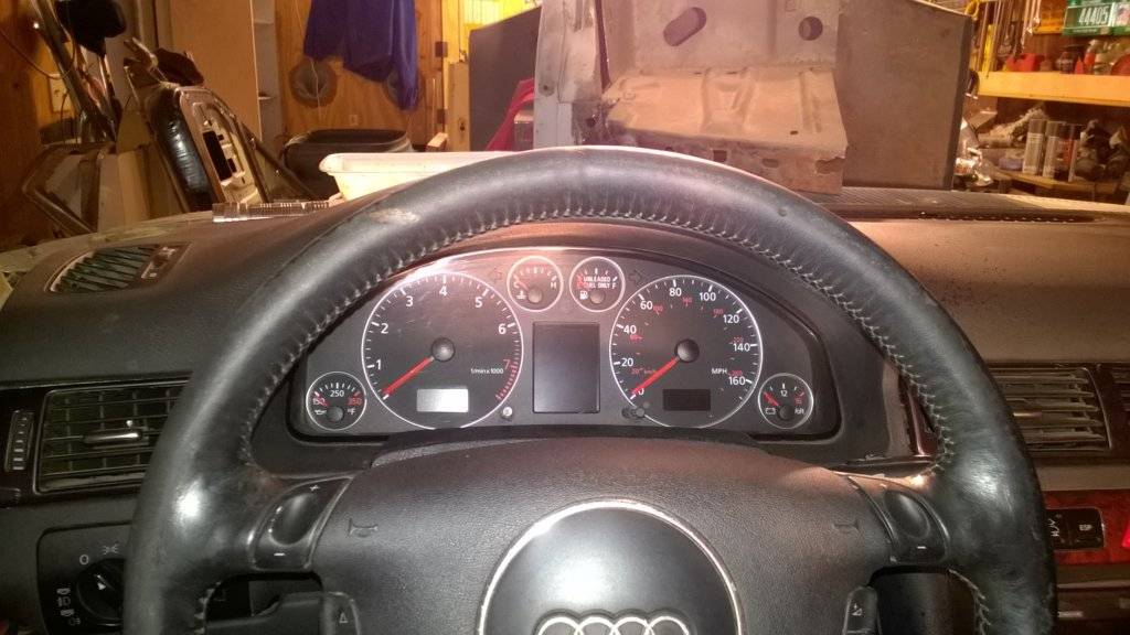

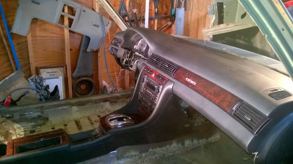

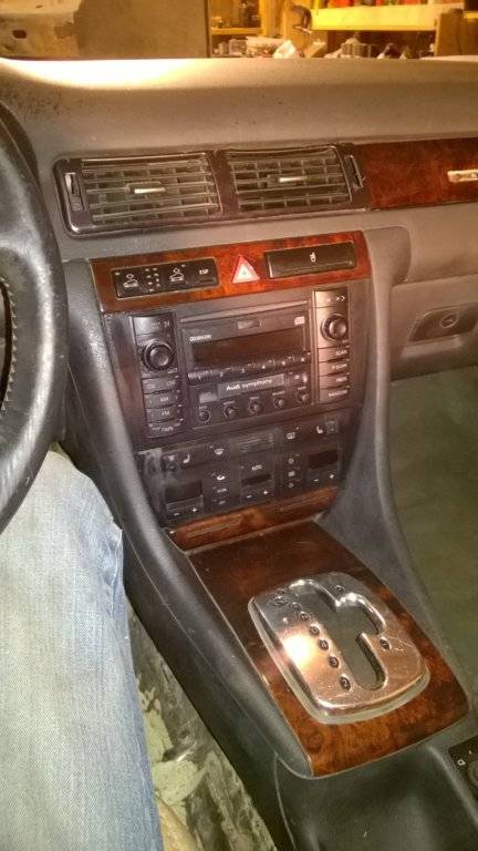

Well, I think let a few pictures of the Yankee Express say what I think on this subject.
WP_20161106_13_38_57_Pro.jpg WP_20161106_16_41_56_Pro.jpg WP_20161106_16_42_05_Pro.jpg WP_20161106_16_42_12_Pro.jpg WP_20161106_16_42_31_Pro.jpg WP_20161106_16_42_36_Pro.jpg WP_20161106_16_46_12_Pro.jpg WP_20161106_16_46_28_Pro.jpg WP_20161106_16_46_32_Pro.jpg WP_20161106_16_46_41_Pro.jpg

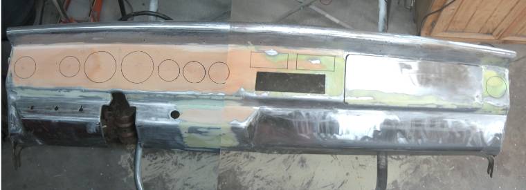

Here's a pic of what I'm doing. AutoMeter gauges, AC vents, radio and a modified glove box are the basic changes. The glove box was narrowed 4" to make room for an AC vent on the passenger's side, a modern radio with rectangular AC vents above it and another round AC vent on the driver's side. The ash tray has also been deleted and the AC controls will go there. All the holes have now been cut and fitted and all the finish body work has been done. Final paint was this morning and with a quick cut & buff it will be ready to go in the car. I'll post pics once the paint is dry enough to stick the gauges and vents in. I also filled all the dash pad holes so I wouldn't have to spend $$$ for a new one.

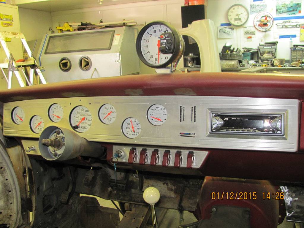

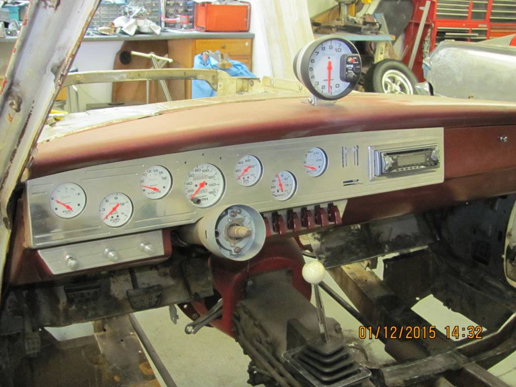

On my 65 AFX car I used autometer gauges , 6 toggle switches with red covers , moved the ign. switch over 1 inch to fit the switches in place . moved the light switch down with the others , A metal edge was welded on the original dash to rotate the new one up to the drivers eye level . installed vintage air controls in the dash with a cd player for music ,

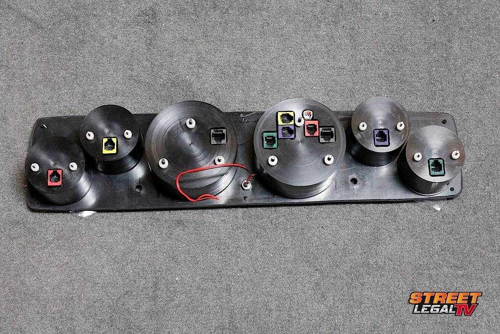

I kept the dash plastic and painted it with Rustoleum paints: metallic silver and metallic black. I wanted a full set of gauges so I cut apart my cluster (it was broken and cracked anyway) and made an ABS plate that I'm going to have duplicated in aluminum. It turned out pretty decent for my likes...
Hey '65, that's a clean look I might like to emulate on my '64 Fury; what kind of gauges are you using?

Hey Centerline, I love the way you welded up the original cluster/heater opening to make a larger area for the new gauges; I never thought of that on my '64 Fury but now you've got me thinking!
Thanks!

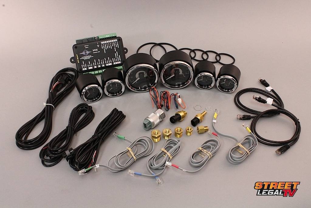

The gauges are Dakota Digital's VHX-1060. I had another brand in there, but couldn't read any of the gauges at night, so I went with this setup. You can read these gauges and the info center in any lighting condition, even bright light directly on the gauge. I'm actually installing another Dakota gauge set in another car I own... love these gauges!
