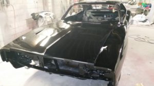

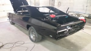

I have started on this project with my dad, he has owned the car for 15+ years (maybe closer to 20) anyway many years ago he had the majority of the metal and fab work done then had it painted red with white tail stripe and had trim holes for a vinyl top. It has sat in storage in that state until this past september. My first thoughts were to leave the paint alone and start reassembly myself but after a closer look at the paint we decided on a repaint. Long years in storage had left the charger with many scratches and small dents plus I wanted to fill the trim holes and leave the vinyl top off. (Much to my dad's disagreement!) So we had the car painted black and now the plan is to have black with a red tail stripe and red interior. The car will be a bit of a restomod. The exterior will look mostly factory with the exception of a lowered stance and 17" wheels. The interior will look factory but I would like to upgrade the gauges and sound system. Suspension will be factory engineering with a modern twist. We have a 440 with a "recent" rebuild that will get opened up and gone through.

Nice choice. Welcome.
Welcome to the site. Your car looks just like mine did a few years ago. I ended up going black, black, black, and black to keep the better half happy. She just loves it, me not so much just for the fact it is so hard to keep clean.
Lol. Well it's always best to keep the wife happy first. Others warned me about black being a dust magnet too. The painter wasnt particularly pleased with the decision either! Your car is gorgeous its worth all the extra washing:thumbsup:
