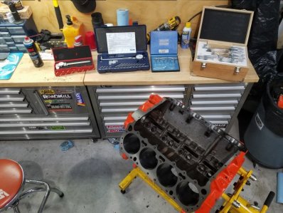

Hi good folks of FBBO,
I will be posting build pics on this thread along with questions since its my first mopar build. I recently got my 440 block back from the Machinist (which took a year). This place was so so. The stroker kit is from 440 source. My plans are for a mild 512 stroker that tickles the 600hp mark. 10.5-1 Compression with trickflow 240 heads. Haven't decided on a cam yet. My first question will be along with pictures. The cam bearing that also has the oil holes for the heads seems to be a little miss aligned and need some advice on how to resolve the issue. Any questions or Comments welcome.
Same combo here.
Did you have the machine shop check the pins? Every source kit I've used (they will tell you this too when you buy it) the pins were tight.
I use durabond cam bearings.
I used to obsess over the oil hole being completely aligned until I started putting in my own cam bearings, ran out of patience and threw one together less than perfectly aligned.
Haven't had an issue.
Same combo here.
Yes I had the machine shop check and hone the pin bores perfect. All is well on that front.
Checking it all out and it looks spot on. Now for some more prep and casting flash removal. Waiting on a block cleaning brush set. Any tips for cleaning the block other than just get every nook and cranny. Pressure washing?
Ok here is a question that I have. I got ARP main cap bolts. I had the Machine shop use the stock main cap bolts for line honing. I will check both with a bore gauge. How important would it be to re linehone the block for the ARP's?
If you're replacing the bolts with main studs, that's when it is said that you would need to re line hone.
check he bolts against the studs, where you are most likely to run into trouble is if the studs have a larger diameter up the shaft , than the studs. torque them down and check the parting lines in the block.
At least they had the bearing lined up...but either not in far enough, or too far. Probably oil okay. Or, possibly 'borrow' their cam bearing tool, to move the bearing into place.
