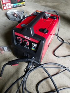

I bought a Lincoln electric 140 Pro-Mig from Lowe's, followed the set up steps to the tee and I can't get it working. I've even touched the wire feed directly to the ground clamp and not even a spark. This is actually the second welder from Lowe's because I thought there had to be a problem with the first. What am I missing?

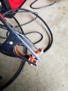

No spark. Spool feeds just fine. I've cleaned each connection. Internal Fan turns on when on switch is in on position. I've tried each voltage option on the welder. Checked the outlet and I have 110 at the wall.

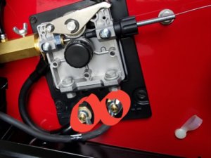

You need to check the connections for both the ground and for the liner (which is the other conductor). These are sometimes left off because the machines can be set up for either positive or negative ground.
I have continuity across the two circled posts and continuity from the ground clamp to the posts. Even if I'm not getting a good enough connection on the metal, shouldn't I have a spark with the ground clamp and the wire feed?

It sounds like you have a tester (multimeter) so test continuity between the contactor tip at the end of your whip and the big brass connector where the wire feeds through. Take the end of the whip apart and make sure the liner protrudes enough to attach to the end fittings - the liner is the conductor.

The ground clamp is the one on the right. It is labeled as positive. This is the way the manual said to set it up for wire feed. So is that correct?
