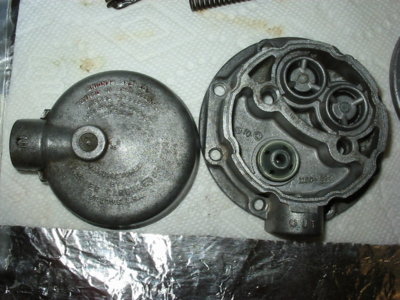

Mancini kit is not for original Carter pumps based on picture. They show a 6 hole diaphragm which is similar to Ford/Chevy versions. Mopar Carter pumps are 8 hole. THere are other companies that sell a good kit for rebuild. I have done several for Hemi motors. Remember not all pumps are rebuildable, in fact originals for 383/440 were not. Different type.
There are a few companies that can rebuild original pumps........
Back to the topic of newer pumps...ski I believe it was the MR version....
Doesn't matter new or original, you need to know what you have. I have rebuild new carter pumps too. If Mancini has there own brand made by carter with 6 holes, which mimic the Chevy Ford versions it won't work on other Carter pumps using 8 holes with out modification.
The internals are all the same other then spring tension and obviously the lever arm.
But for an OEM motor you would have had a 8 screw Carter.
