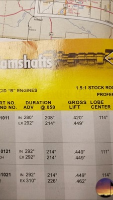

No way would I run the Erson cam- the one you show is for a 340 not 440

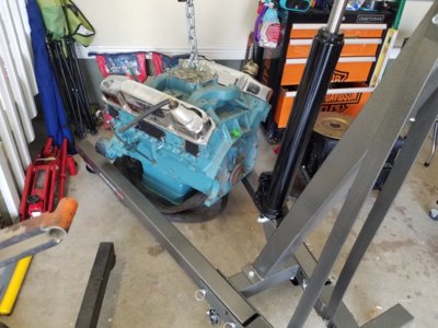

So I live in Colorado, the cam I posted a pic of was what's inside it now lol. This weekend I'll pull the heads off and look and see what style piston are inside. So as for now ill keep the 440 RPM manifold and i do plan on putting in a sure grip rear and 3:55. But over all do you guys think 1200.00 for the entire motor was a decent deal? The car is a 66 fury 3 with a 383 in her now. Transmission is 728 auto, with dual exhaust and stock rear end.. I plan on running aftermarket heads and might change out the pistons once I see what they are.

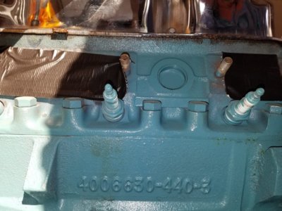

shoot us the casting number off the heads and numbers off the block

From the one photo it looks like there are many aftermarket parts on the engine?

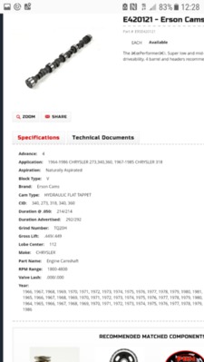

So here is the pic of the block number and the cam specs. The cam is the 2nd one down with the . 449 lift listed.

cam 449lift 292 214@50 looks like an Erson TQ20H but their catalog now lists it at 112 lobe center where you show 111

449 292 214 Erson
