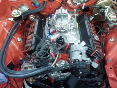

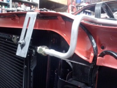

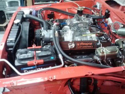

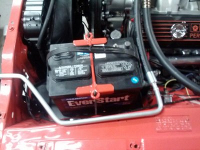

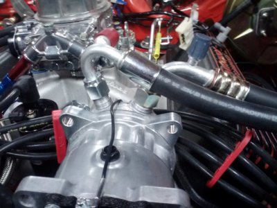

'71 RR. I had a friend who had some aluminum tubing and he welds aluminum, so I made my own. Then another friend had the crimping tool for the connections. Sanden compressor, original condenser and factory controls working it all. Only difference is i put my lines going to the drivers side just because thee is a lot going on the passenger side. I just wanted it to look a little even.

You are the man! Mind if I ask you 1000 questions and ask for a few more photos?

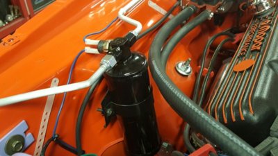

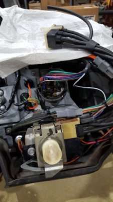

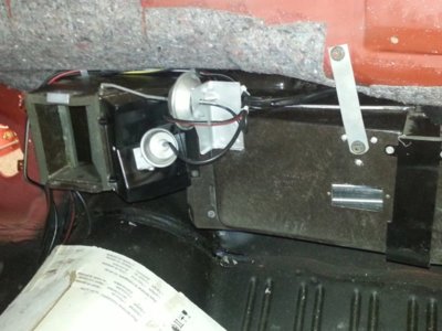

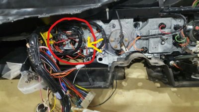

Here's some more
Dash-back.jpg HB intalled.jpg Inkedthumbnail_20170225_192243_resized_LI.jpg Rec-Drier.jpg
Sure. I'll help as I can

So let me start with the lines. Where’d you get them? I see Vintage air has a universal kit but i’m skeptical about them working with the ports at my firewall How’d you get fittings that would work with your factory lines coming from the firewall? Next, where do you have your pressure switch mounted?
I put hardlines on my Classic Air kit. I bent up fuel line and took the pattern to the local fitting business we have here (Amazon) and they bent them up and put the "bump" on the ends for me and it was done. The flex lines I took to Classics warehouse here and they crimped them for me. Looks factory and it was simple.
A friend of mine had aluminum tubing. I first installed the condenser and worked from there. Using some welding rod(s), I formed where I wanted the lines to go and where it would fit right. Then I took the aluminum lines and replicated the welding rod using a tube bender. Another friend has a "mom and pop" garage and he does A/C work. He was the one that had the crimper tool to swag onto the rubber lines. He also had the two connectors that went to the condenser. I then went back to the friend who had the aluminum tubing, gave him the ends that would fit the condenser, and he welded them together. After it was all done, I cleaned the tubes off and sprayed a clear coat on them just for protection. Most of my kit came from Bouchillon Performance and I think some if not most of Randy's kit comes from Classic or Vintage. He has the connectors out of the firewall as well.
There's a switch at the receiver/drier and a sense/cycle switch mounted on the line right at the firewall.
His kit is very good. As I said in my previous response. Everything lined up and no issues and he had my condenser.
Speaking of a condenser and the "universal" kit. I did have one of those universal ones but the inlet and outlet would interfere at the bottom (that's where they were at). You won't be able to connect the hard lines to it without hacking part of your radiator support, which I didn't want to.
My ar originally came with A/C but most of the components was gone. It's back on but a more modern look now.
Also, how’d you get your factory controls to work with it?
Factory controls work fine with it. I had the original heater box so I disassembled and rebuilt it. It is operated via vacuum and a vacuum can. Just had to run a power wire for the compressor. Check the FSM wiring diagram. If you don't have one, download it at mymopar.com

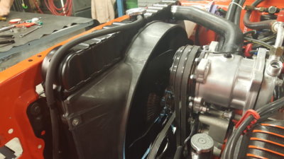

This is what i’m looking at now. How well does the condenser fit behind the radiator?
The condenser fits in front of the rad. I will post some pictures this afternoon as the bumper is off being rechromed. The Bouchillion compressor mounts are very nice.
