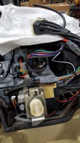

Can it be done with the gauges in the car? My controls don’t work at the moment but I’ve bought new vacuum lines and hopefully i can get them working.
What is wrong with the controls? Do you need a new blower switch?

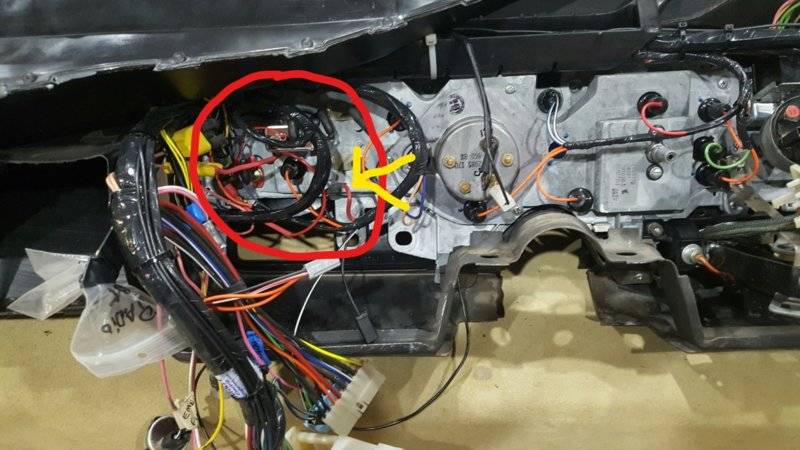

Yes. The control pod for A/C and heat is separate, having 2 nuts/studs holding it in if I remember right. The only issue would be fishing all the vacuum lines from the left, to the right. It would be to your benefit to loosen and or remove the whole instrument cluster to put the vacuum lines in.
Not sure. The blower works but it won’t turn off with the switch
Check the switch. I might have another new one but have to check. Ive also seen them on line as well.
