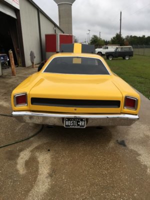

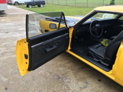

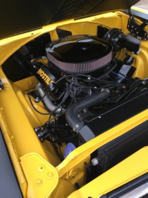

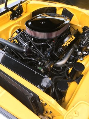

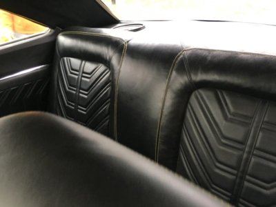

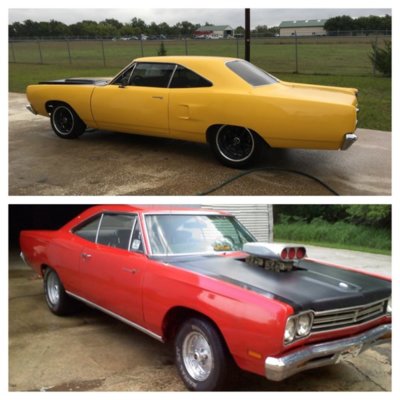

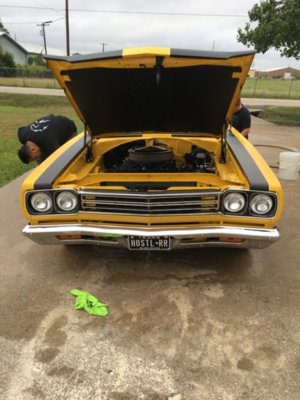

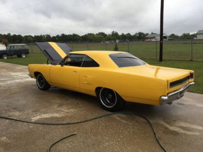

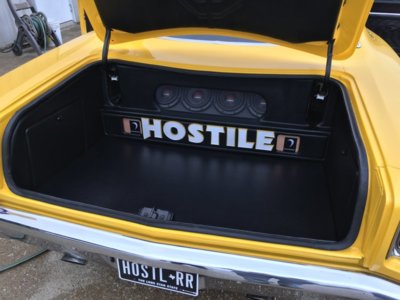

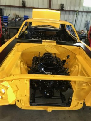

My 3 year build is close to completion. This build is a total nut and bolt restoration. It is very unique car the front and back are a 1969 rr and the sides are 1970 rr. I wanted the car low and we thought it would look lower with out a ridge line on the side so we took a 1969 car and modified it with 70 quarters. Could not get 70 fenders so we pounded the ridge line out of the car. Shaved side lights and added flush mounted door handles. The drive train is a 1969 440 bored 60 over and custom port polished heads, high performance cam. It has a fuel injected six pack. The rear end is a strange Dana 60 with 370 gears.Custom aluminum drive shaft and tremec 5 speed with hydraulic clutch. The exhaust is 3 stainless welded smooth and powder coated black. The whole engine is painted in high temp powder coated black. The interior is 100 percent custom leather. It has a 5000 dollar custom stereo with nav and backup camera. The seats are out of a Cts-v modified to low back. The car is painted viper race yellow with some pearl. The car is about 95% complete hope you like it as much as I do.

Stock suspension??
Car has QA1 shocks and lower control arms, has QA1 tubular k member, has complete hotkis suspension including 1.5 inch lower leaf springs
That came together really well, I like the way you blended the two years. It looks as good as a factory concept car would have.
Every damn time I get it on my head to go completely stock. Someone knocks one of these out. I'm amazed how well this looks.

Is that the F&B 3x2 system?
Did they do the black throttle bodies for you and is that anodized or??
Very nice, I see you did the wiper motor delete, did you also do wiper arm delete? And do you have photos of the under fender hose routing.
Also it looks like you used the Kindig door handles were they an easy install?
Dude! I've always sort of disliked the ridge lines on the 68 and 69 Plymouth B body. If I had all of the cool mopars I wanted already and was looking to do another, I'd get a 68 and shave those off. I thought everyone would hate me if I did that. Part of why I like the 70 is the smooth sides. Post more pics, I want to see those front fenders. Car looks good!
