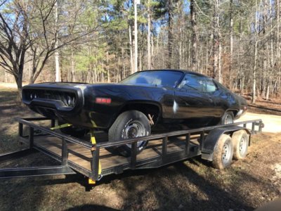

Y’all are awesome. I appreciate all the info. I only have one pic and that’s when I came home from getting her.
