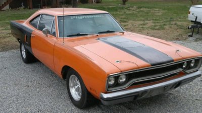

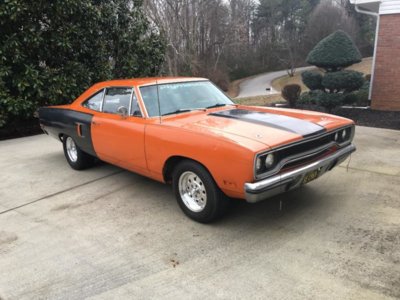

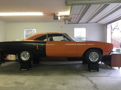

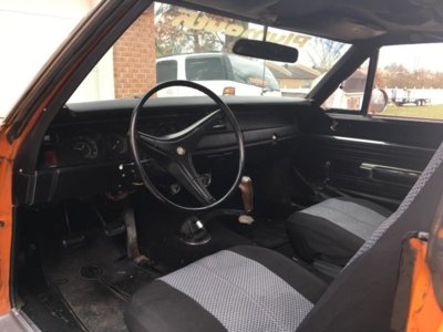

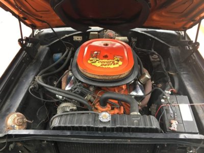

  • Finally starting a build thread for my 1970 Roadrunner. Car was purchased February 2016 after being owned by the same guy since 1999. Car had an attempted repaint sometime in its life and the previous owner had quarters and a 2 piece trunk pan installed sometime between 99 and 2016. He also traded the gull wing for a pair of bucket seats requiring me to find a bench seat and deck lid. Here are the pics starting from the first picture I took after pulling car out of his garage, the ride home, arrival home and then up on blocks to begin disassembly.

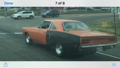

Located the owner of car from 1982 who shared some 110 film pictures of car in the 80's. Notice it has the Plymouth windshield visor still on car when I purchased it.

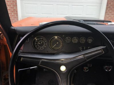

I got my gauges back in December after being gone 15 months. I left the mileage at 60K which is the cars original miles. Also had the wiper motor refurbished and created a vintage spare tire. In the process of painting dash, steering column and polishing my stainless trim.

Question - what are those wheel stands under the car (last pic in post #1) and how did you get the car up on them?

Engine was replaced by 1980's owner with a 440. Just got block back Friday and am
They are called Race Ramps. Blocks have handles on them and weigh approx 5 lbs each. The are Concave on the top to rest wheels in and stack nicely when not in use. Best $200 dollars I ever spent. I used a floor jack and 4x4 wooden blocks to lift car under center of rear axle and center of K member, lifting one end at a time. They are rated at 1500 lbs per corner or 6000 lbs total capicity. Also a great & Safe way to introduce your kids to the joys of undercarriage stripping!!! Well safe except for the one in bare feet :screwy:
