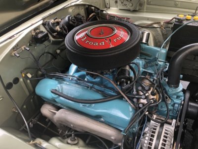

I am getting ready to rebuild my 68 gtx 440 ,four speed ,Dana 354 original engine. I want to retain the stock intake and exhaust manifolds. I am asking for suggestions on Cam, ( solid or hydraulic ). Lift and duration for the best power and dependability. Also interested in questions on head work and exhaust manifold work with retaining stock parts. Wanting a combination that works very well with basically a stock 68 HP 440 motor . It has new TTI 2 1/2 inch exhaust . Thanks for any help I have never done anything stock before this is new for me . I want maximum power and dependability with a stock appearance . Also ignition is converted to electronic by way of pertronics kit and high output per Tronics coil. Also I have a set of Mopar performance/crane 1.5 roller rockers .
