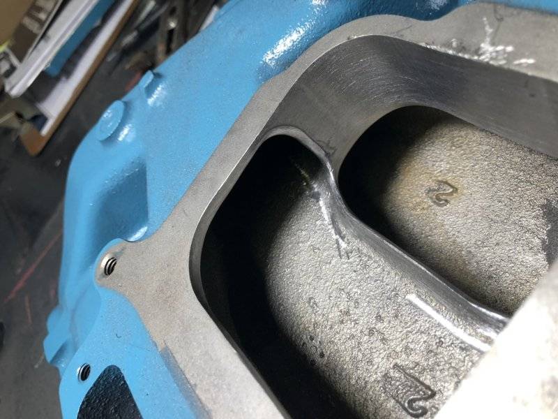

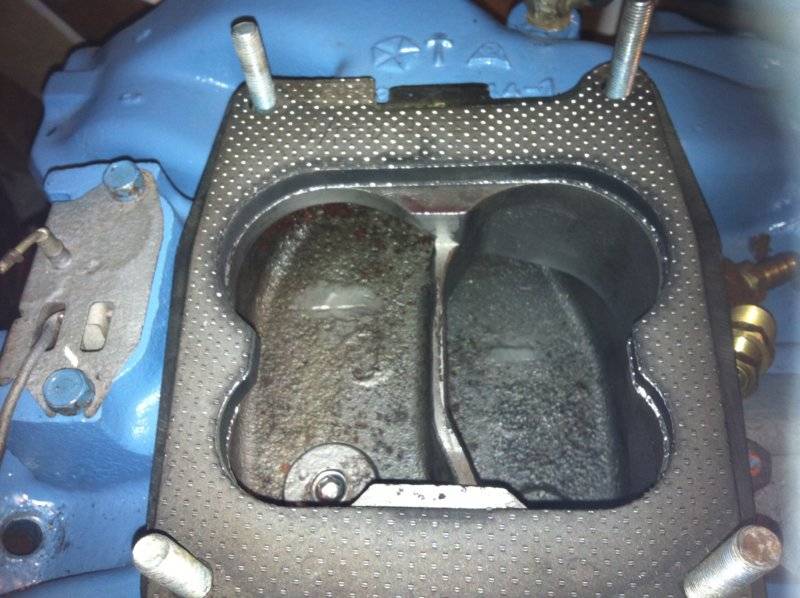

Hi, I built a 1969 GTX a few years back as "stock" Factory intake...906 heads ported by me...But I ran a "Bullet" cam--It was awesome...I called them and had them grind one based on NHRA stock lift for 1969--but have similar dimensions to stock so it would idle and sound stock. They built me a heck of a cam for under 200.00 and idled well. I had full 2.5 TTI exhaust on factory manifolds. I found some 40 yr old Poly Glas 14 tires to mount on stock Magnum rims. Carter correct 750cfm carb for the year....4:10 gears...low stall converter to avoid spinning..That car ran on first time out 13.62 at 102 spinning quite abit, but she really had top end..used 6 pack pistons that were 0 deck and the 906 heads were milled .070 or so. Ran factory choke.....The real problem was that intake manifold--it is a real stinker for 1969-71...I ran a similar set up years before in my 71 Cuda -but I could use any cast intake--and The best Mopar Cast intake for flow and power hands down for single 4 barrel was the 440 Thermoquad intake. I had the center meat all cut out and ran a 5/8 tall wall only...In testing it was 2/10 faster than an M-1 dual plane aluminum intake of the day and also the same amount over a 1971 type cast iron intake with center taken out...If you can sneak a Thermocough intake on a factory set up--go for it...Just get the center taken out and leave walls around 5/8 tall or so...….I am just finishing a 1971 Cuda FAST type now. Just need to put on passenger side head pipe from TTI. 6 Pack set up. 493 CID 440. .030 440 with 4.15 crank (all that was available last fall). Porter solid roller .625 lift on a 114 lobe separation with Mancini 1.6 rockers....13.9 compression- Mancini Kit...Diamond pistons..New 452 castings I found on Ebay for 80.00 flow 282 intake and 200 exhaust. Living in MN I used to race 2 of the FAST guys --Wayne Nelson and Joel -with their 69 vette and 67 GTX at the time..BIR race track. Did well and that was fun, but they got rid of a Stock program at that track and it has not been the same for 15 years. SO I am building the car for the fun of it.

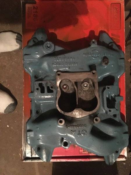

View attachment 763054 View attachment 763051 View attachment 763049 View attachment 763049 View attachment 763049 View attachment 763049 Hi, I built a 1969 GTX a few years back as "stock" Factory intake...906 heads ported by me...But I ran a "Bullet" cam--It was awesome...I called them and had them grind one based on NHRA stock lift for 1969--but have similar dimensions to stock so it would idle and sound stock. They built me a heck of a cam for under 200.00 and idled well. I had full 2.5 TTI exhaust on factory manifolds. I found some 40 yr old Poly Glas 14 tires to mount on stock Magnum rims. Carter correct 750cfm carb for the year....4:10 gears...low stall converter to avoid spinning..That car ran on first time out 13.62 at 102 spinning quite abit, but she really had top end..used 6 pack pistons that were 0 deck and the 906 heads were milled .070 or so. Ran factory choke.....The real problem was that intake manifold--it is a real stinker for 1969-71...I ran a similar set up years before in my 71 Cuda -but I could use any cast intake--and The best Mopar Cast intake for flow and power hands down for single 4 barrel was the 440 Thermoquad intake. I had the center meat all cut out and ran a 5/8 tall wall only...In testing it was 2/10 faster than an M-1 dual plane aluminum intake of the day and also the same amount over a 1971 type cast iron intake with center taken out...If you can sneak a Thermocough intake on a factory set up--go for it...Just get the center taken out and leave walls around 5/8 tall or so...….I am just finishing a 1971 Cuda FAST type now. Just need to put on passenger side head pipe from TTI. 6 Pack set up. 493 CID 440. .030 440 with 4.15 crank (all that was available last fall). Porter solid roller .625 lift on a 114 lobe separation with Mancini 1.6 rockers....13.9 compression- Mancini Kit...Diamond pistons..New 452 castings I found on Ebay for 80.00 flow 282 intake and 200 exhaust. Living in MN I used to race 2 of the FAST guys --Wayne Nelson and Joel -with their 69 vette and 67 GTX at the time..BIR race track. Did well and that was fun, but they got rid of a Stock program at that track and it has not been the same for 15 years. SO I am building the car for the fun of it.
You are right I did that to my Iron TQ intake and it ran very well, with manifolds iron intake a 850 tq mild hydraulic from bullet in a wide separation and of bowl blended 452 heads my 79 Magnum weighing 4200lbs ran a best of 12.68 109 mph. With Performer ran 12.90.

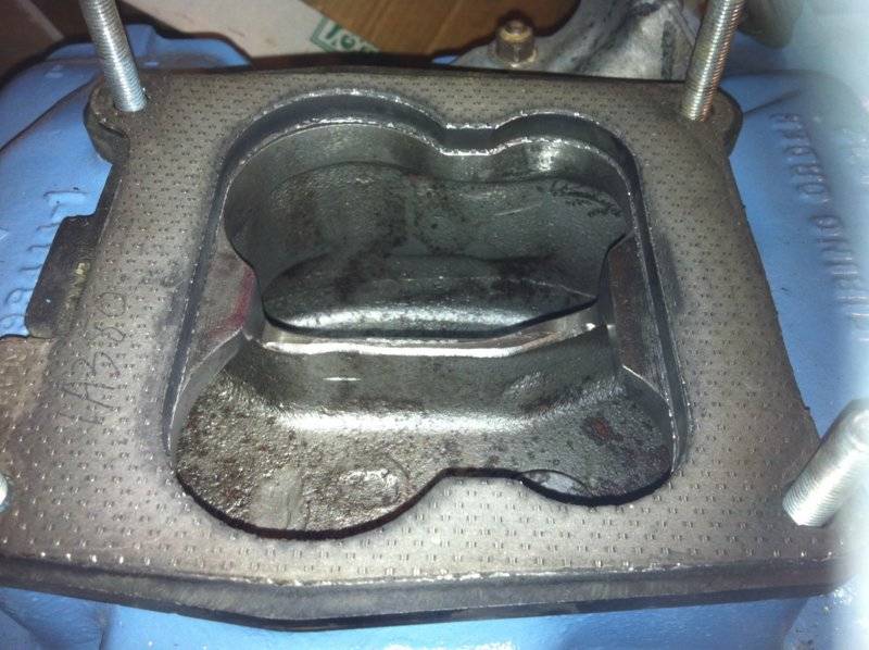

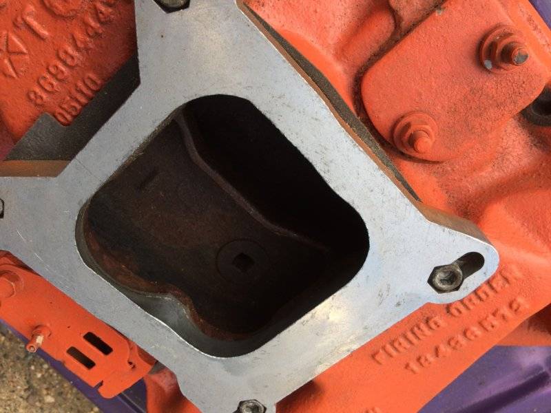

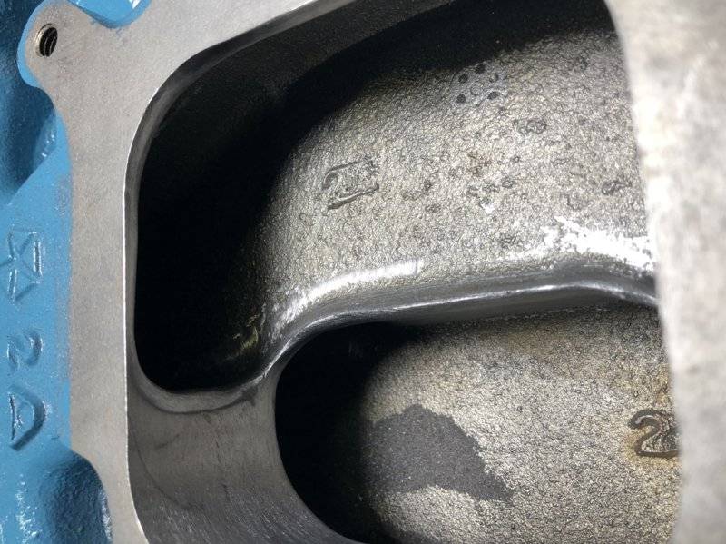

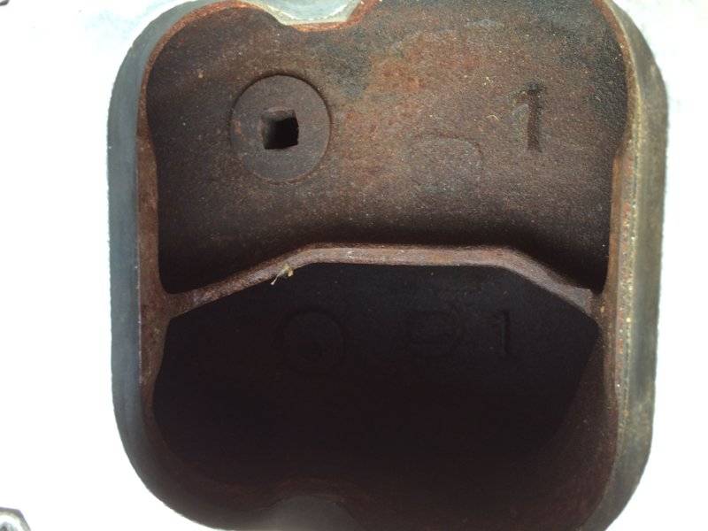

Exactly! I found my success out by God's grace. The 1971 intake and the M-1 aluminum that copied it, back in the 90's were such a pooch, and I had a Thermocough laying around so, I took it to my machinist on a whim to test. Our factory class at BIR had to have a cast iron factory intake. Mine is hogged out a little more than yours. Adaptor to run a 1971 Carter AVS 4968 750 cfm AVS also gives it more plenum volume. I posted 11.89 at 112mph with that. We could run Hoosier Quick Time Pro tires. We just had to have exhaust all the way back, So I was able to run TTI 3 inch right when they first came out basically. A 9.5 Dynamic converter was a great converter. Racer Brown Hydraulic 300 Duration 254 @ .050 with stamped steel rockers and heavy 6 pack pistons...Trying a bunch of cams in that combo, that hydraulic RB ran the best beating any solid I ever tried. STH-41 or 42 grind that cam is. Really makes a 440 go in my opinion for hydraulics. .Here is a picture of my intake.

Well...... that really opens up the doors for a bunch of cams that just won’t yield positive results when used with ex manifolds(which would more than likely include that RB 300* hyd that you were using).

I ran 11.89 with Hooker Comps and full TTI exhaust on that car. For an MSRA (Minnesota Street Rods) event at BIR I put factory 68-69 HP exhaust on and the appropriate head tubes from TTI to match the exhaust near the H pipe. Same set up, just factory exhaust manifolds --Car went to a 12.20 et. So, 3 tenths loss or so. Late August hot and humid MN temps...
At roughly 3800lbs....... that’s about a 32hp difference.
In FAST, the TQ manifold wouldn’t be legal, or the 3” exhaust...... or the sticky tires.
Correct. but at BIR, for the time period, it was allowed. This was before FAST was created.
You are right I did that to my Iron TQ intake and it ran very well, with manifolds iron intake a 850 tq mild hydraulic from bullet in a wide separation and of bowl blended 452 heads my 79 Magnum weighing 4200lbs ran a best of 12.68 109 mph. With Performer ran 12.90.View attachment 763629 View attachment 763630 View attachment 763631

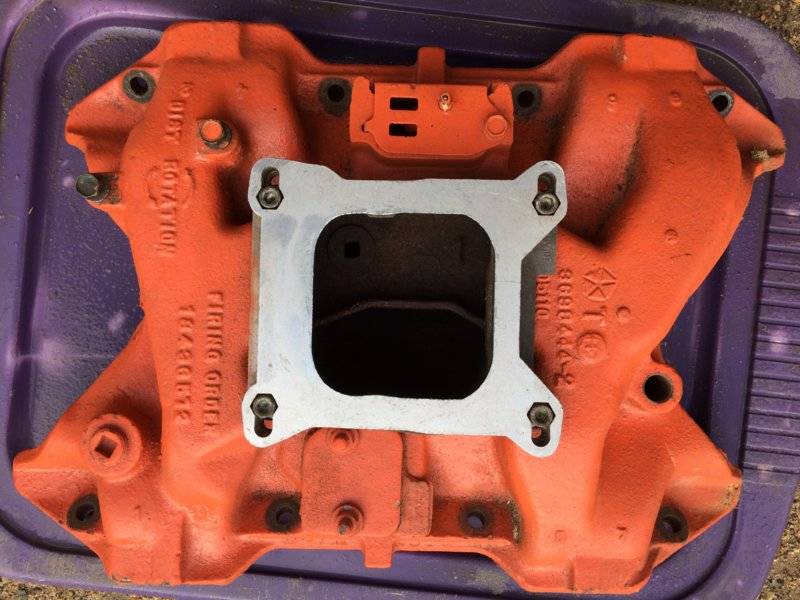

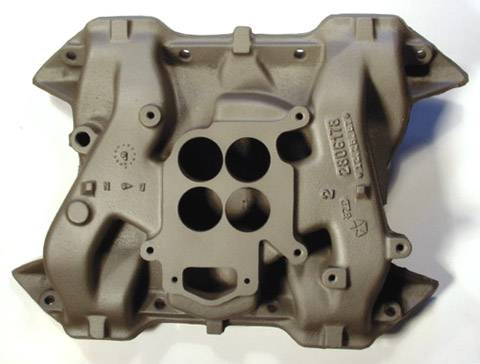

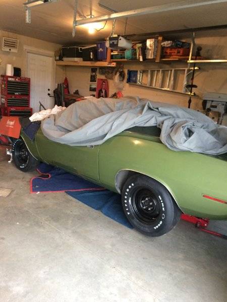

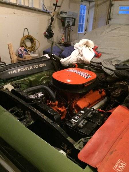

I have a choice on my build between 2 different mopar cast iron intakes. One is like yours a 3698444-2 or a 2806178. Which would you guys think is better?
Here is a pic of the 2806178 It was used in 67-69
The Thermoquad intake without a doubt will make A lot more HP. Get rid of the center guts and keep the dividing wall 1/2-5/8 or so. In my opinion. The other is a dog.
I am starting to consider painting a ch4b intake do to the 68 intake restriction to flow. But definitely want to keep the factory exhaust manifold . The bullet Cam sounds interesting as well. Thanks for the information.

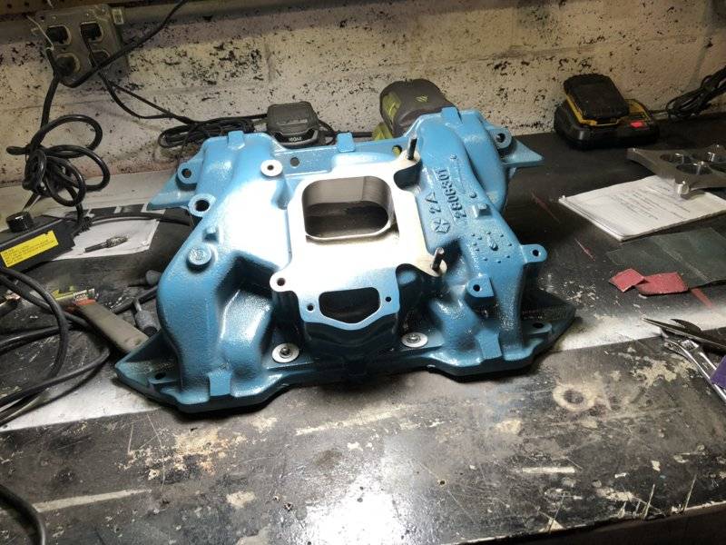

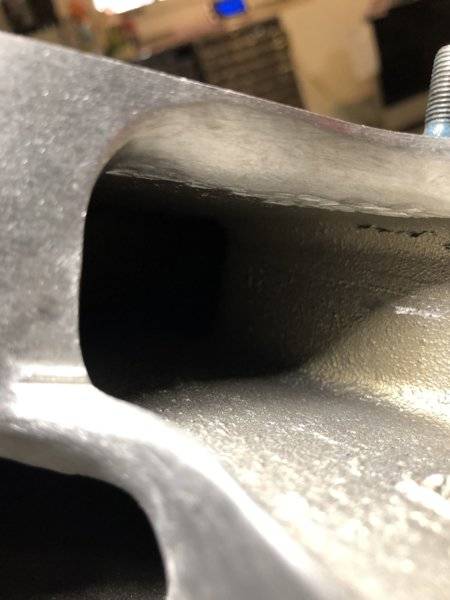

Those later intakes are much better than the earlier one. After I spend many hours playing with mine I got my Runner to 12.1 @ 113.9
562A24CE-51EF-4763-86FF-E68EFD15D0AA.jpeg 6D23B014-9B48-4699-94EB-3D8741734639.jpeg 36B146D8-7CE3-4EED-8E2C-99CD4D1F9B1B.jpeg 20BA242F-A2A0-45DE-B965-097343B1AFA0.jpeg
