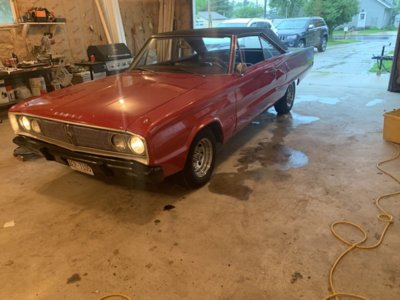

finally got my dream car. Have a lot I want to do. Originally a 273 car that someone converted to the /6. Wanna get all your thoughts. I want to swap a small block v8 back into this beauty but not sure what I should go with. Looking for a tire burning street car mainly. 318? 360? I know the slant has its cult following but I am not in love with it.
I have found a bunch of 318 cores for less than $200 so I was thinking about going that route. I have a few guys at work that say not to waste my time rebuilding one. But I wouldn’t trust them changing an air filter either lol.
If you want to cruise and enjoy the drive the 318 is great. If you want to do burnouts and hot rod then 360 minimum or go the BB. My Coronet is a 318 and it cruises down the Interstate all day long at 80 mph and works just fine.

I thought the same thing but according to vin it says 273. Someone did some work to the slant at some point. Has headers and intake with a Carter afb. Wish I knew more about the cars history.
Welcome to FBBO. 440 RB for sure. You already have the V8 k frame, if the radiator support isn't big enough for a 26" radiator then swap in a new support from one of the suppliers. We can help you with answers and guidance if you need it. Welcome to the madness!

No, not if it came with any V8. Mine had a 318. The only exception is if it had a Hemi, different K frame there.
B-bodies 62-72
There are three basic combinations with this body style. The slant six, the V-8, and the Hemi. This makes engine swaps very easy, if you have a V-8 K-member. Simply locate the correct brackets and insulators and bolt them in. Six cylinder conversions will require the change to the V-8 K-member. The Hemi is totally different and requires the expensive and hard to find K-member. Example: a '66 Charger with a 318 can become a 383 or 440 car with relative ease.

okay great. I have mainly been looking at SB cores because I wasn’t sure a BB was really an option. I would prefer a big block so I am going to start shopping around. I am sure I am going to have a lot of questions over the next few months lol. Glad I found this website.
