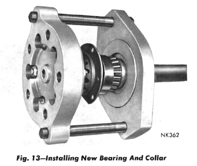

Like many things, to each his own but the FSM shows pressing the collar and that's the way just about any shop does it; no epidemic of "cracking".
I've seen and used this tool....once. i realise it draws the bearing jn place evenly by turning the draw bolts....but how many of us "shade tree mechanics" have this tool at their disposal? I do not. What the FSM pix shows is the cup and cone being drawn on the axle. The component behind the bearing cone assembly is part of the pressing arbor that pushes the cone into position. Not shown is the retaining ring that holds the bearing cone in place. This method along with the heat to expand method all but eliminates damage to the components.
I would hazard a guess that most guys do not have this tool and use a hammer and drift pin to put the bearing cone and retaining collar in place. My choice is to heat the components to expand them for a slip fit installation....so...who is correct? Its up to to installer to determine the "best way"....just my opinion of course.
