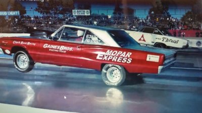

My motor/chassis/combo in my coronet was very similar to yours and my 3750lb sled went 10.04 and 131.5x.
Only thing I can think of (if your motor is right on) is the tires. I ran Hoosier 11.25 tread width bias slicks, 29 inches tall . Could be your tires. Your 60 foot should be in the 1.36s or so.
