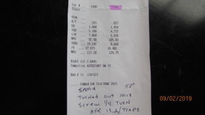

I'll see if I can post that.
a 9"will rarely stall much higher than 5000ish . You will need to go 8"to get a lot more .
you have HP , but you are missing something else . Can you post a timeslip ? I would like to see the splits
Tex
Here ya go.

I would think it would go in the 9's, Doesn't spin a tire, always hooks. Lenny and ATI suggested the 8" vert. Lenny doesn't want to loosen because I drive on the street. What would happen if I had a 8" vert that would flash to 5500, 60 like a bitch at 1.35 and drive it on the street? I need to leave the street talk right out of the conversation with these convertor shops.
I've run a 5600 on the street. Drive it 2 hrs on the highway or more no issue. As for
1.35 60ft, that's a lot tougher than you think. I know ent of 9.50-9.75 cars that barely touch 1.35.
Doug

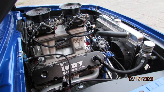

Update on this post. I shaved the Victor MW heads to get 12.5:1 compression, hand ported the Indy intake plenum and added an electric water pump. Ran a best of [email protected]. It now has an Indy tunnel ram with twin Thumper carbs waiting to hit the track. Its going in the 9's this time.
