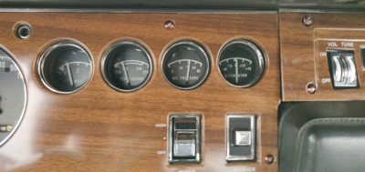

Hey guys, hoping someone can shed some light on what's going on.....

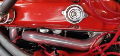

I recently installed a set of headers and did a power steering conversion at the same time. Added new head bolts with some threat sealer to stop leaks.
Ever since the install, my ammeter is boucing around when I'm driving and the temp gauge quickly hits 230-240 when in gear. If i put it in neutral, it comes back down to 170'sh. Never had a heating issue before. Gauge on the rad shows 180. Wondering if the fluid is not properly makes its way around the heads or if this is all connected somehow electrically?? Why does it keep temp in park/neutral, but jump as soon as it's in gear?
Any help is greatly appreciated!!
btw... 906 heads, 440, auto, aluminum rad, tti hedders.

The gauges are all stock. When the car is warmed up (180) I can put it in reverse and the gauge will started to move almost instantly. You figure with higher rpm, the temp should go down, not up. At idle the Ammeter is also somewhat steady. Both worked perfect before... you think the pump can be causing all this? A bad ground may explain the ammeter, but the temp has me stumped.

The heads weren't changed. Just added hedders with new hedder bolts. They first leaked, so I pulled them out and added thread sealer. Leaks stopped with that.

I'm assuming your talking about the '69 Charger in your avatar. If this were my car, the 1'st thing I would do is check system voltage during the occurrence with a DVOM (Digital Volt Ohm Meter)--even a cheap one will give you a useful number for your battery voltage. Attach it to the battery with aligator clips & see where the voltage goes. It sounds like it is going really high--I say this because you say your temp readings go high! Does the Ammeter slam over to "C"? "D"??
Does your fuel level change along with your temp readings, and in the same direction??????
Remember, if your IVR (instrument voltage regulator) is original (mechanical), I'm not certain how accurate it remains as you feed it more than 13 Volts! I really don't think your car is overheating! Your gauges are just seeing alot of voltage!
You put headers on. Did you happen to whack the Voltage Regulator by accident??? Is a field wire making contact with ground & staying there--only while in gear?? It sounds to me like a field wire doesn't touch anything until you make the engine rattle a little after putting it in gear, and it then finds a surface to ground against. I would check that wire (and the harness that runs along the right valve cover for it's entire length).

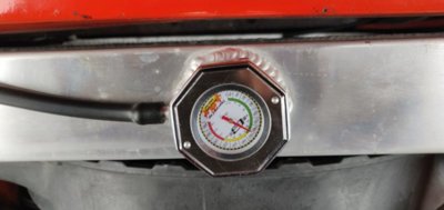

Thanks, I did try with a infrared gun. Rad is cold as a cucumber, water pump also ok. Driver side head a little hot but not

Did you happen to accidently ram the header into to bulkhead connector or any other electrical component while fighting to get the header in place?

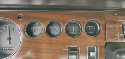

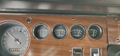

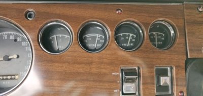

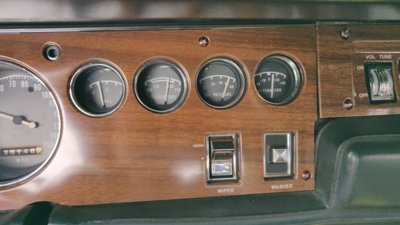

I just came in from a ride. Took it in the highway to see. It's nice and cool out today. On the highway, perfect. 170, ammeter slightly over half solid. No bounce. The minute I got off, ammeter dropped below 0 and temp started to increase. Shot up again. Parked it in my driveway for 20 minutes running. Steady at 170! What the heck?????

The last thing you did before your issue was the header bolts. It sure sounds like an electrical issue to me. Do a detailed inspection of all the wiring everywhere your hands and wrenches were close to.
