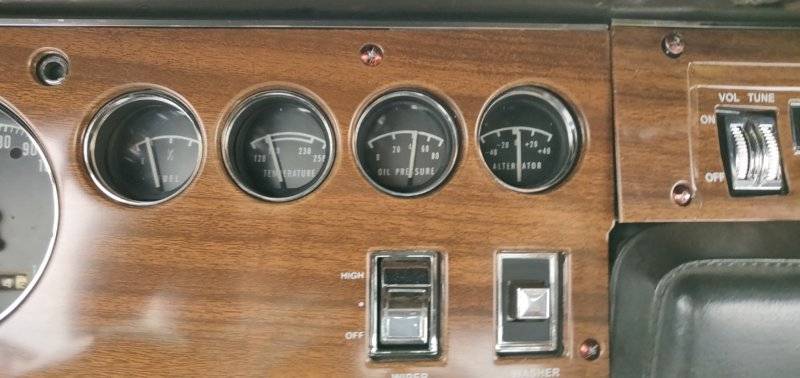

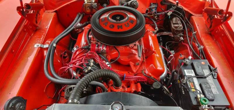

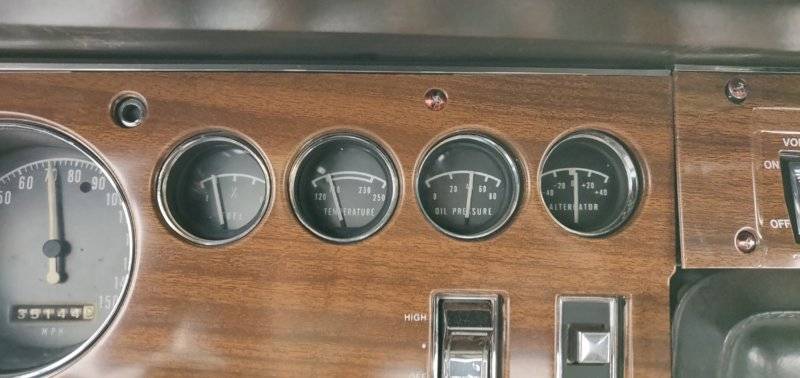

Hey guys, hoping someone can shed some light on what's going on.....

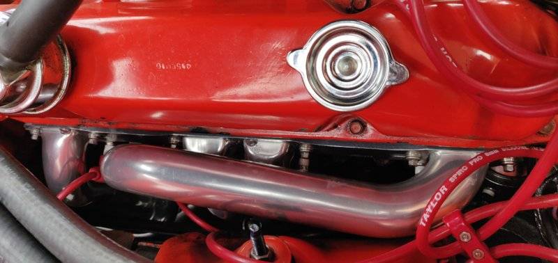

I recently installed a set of headers and did a power steering conversion at the same time. Added new head bolts with some threat sealer to stop leaks.
Ever since the install, my ammeter is boucing around when I'm driving and the temp gauge quickly hits 230-240 when in gear. If i put it in neutral, it comes back down to 170'sh. Never had a heating issue before. Gauge on the rad shows 180. Wondering if the fluid is not properly makes its way around the heads or if this is all connected somehow electrically?? Why does it keep temp in park/neutral, but jump as soon as it's in gear?
Any help is greatly appreciated!!
btw... 906 heads, 440, auto, aluminum rad, tti hedders.

The gauges are all stock. When the car is warmed up (180) I can put it in reverse and the gauge will started to move almost instantly. You figure with higher rpm, the temp should go down, not up. At idle the Ammeter is also somewhat steady. Both worked perfect before... you think the pump can be causing all this? A bad ground may explain the ammeter, but the temp has me stumped.

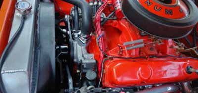

Could the heads be jammed up/plugged? I had the cap off the rad and there was movement. Slow mind you, but there was movement. Could 1 head be clogged?

Make sure no wires got pinched or burned etc by the headers. Shouldn’t be any close but anything is possible. I would also suggest a mechanical temp gauge. Even if just run through the window or something temporarily. Just to rule that out. Also do you mean it instantly gets hot in gear. Without driving. Just making sure. Maybe wires rubbing the gear selector.

do you have a clutch fan or electric fan?

Did you happen to accidently ram the header into to bulkhead connector or any other electrical component while fighting to get the header in place?

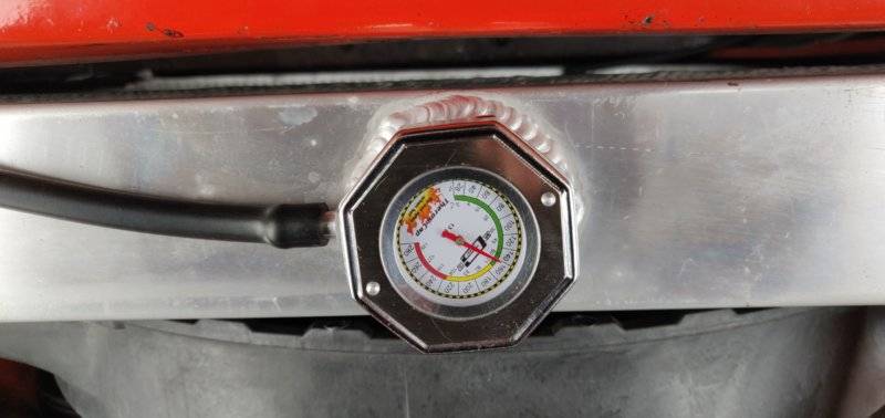

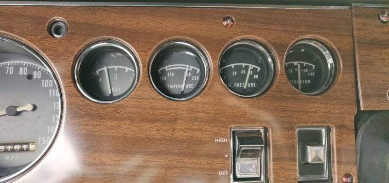

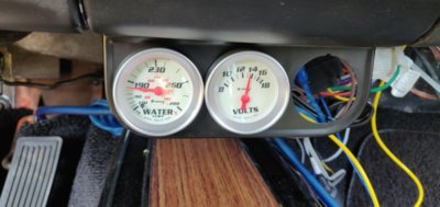

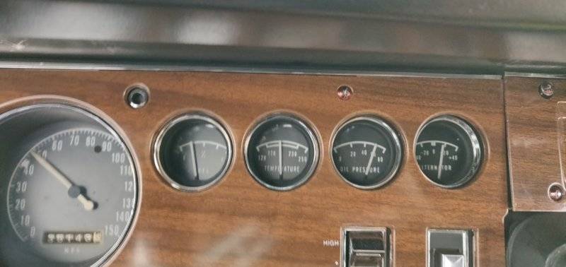

I just came in from a ride. Took it in the highway to see. It's nice and cool out today. On the highway, perfect. 170, ammeter slightly over half solid. No bounce. The minute I got off, ammeter dropped below 0 and temp started to increase. Shot up again. Parked it in my driveway for 20 minutes running. Steady at 170! What the heck?????

I'd definitely run a cheap mechanical gauge temporarily just to rule that out but if it's creeping up and down rapidly my guess is it's electrical and not the cooling.
The last thing you did before your issue was the header bolts. It sure sounds like an electrical issue to me. Do a detailed inspection of all the wiring everywhere your hands and wrenches were close to.
