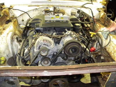

I guess I am going to finally start a build thread on my 68 charger. I wasn’t sure where to put the post. Not a concourse restoration not a restomod either. I had started one under the new modern hemi thread. But after going through installing the 5.7 and 5 speed to me it looked more like a mongrel than a 68 charger. The truck engine is just not a look I wanted. So I pulled it all apart and started the major body work it needed while rethinking the engine.
The history of my car: I purchased it off craigslist sight unseen except for a few pictures about 3 years ago for 7200.00. It was originally a slant six very plain car. 3 speed auto white on white car. It did have a 440 in it and it did run (at least on to my trailer and into the shop)
The engine was date coded 1973. I have a 73 U code out back waiting to be restored with out engine So I wanted to save the 440 for that car. There for the reason to consider the 5.7.
I agree. I am old and old scholl, the modern hemi is great someplaces just maybe not in the 2nd gen Charger!!?

Nice build so far! 5.7L hemi's in stock form are dogs, especially a truck motor.. They need a cam/intake manifold to wake up.
The 426 wedge will be more fun for sure!!!
