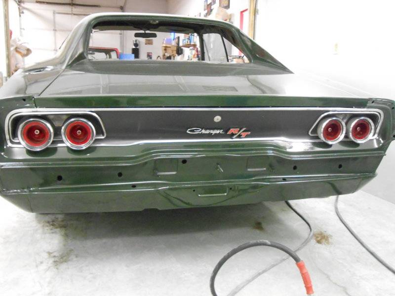

Color looks GREAT! you’re making solid progress, keep the updates comingView attachment 843508 Well I finished up the taillight panel today. And gave it a promotion from once a slant six to a 426 R/T lol. Of coarse that is just for looks and for my satisfaction. I left the fender tag in place that says what it was. And it has its XP29 serial number.

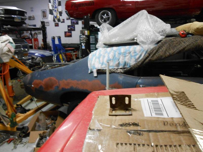

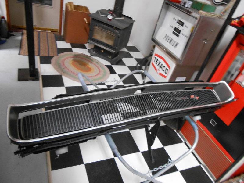

I was missing one of the brackets that connect the bottom of the grille to the fender. Not sure where I can get one as of yet. I don't see them in any of the catalogs.

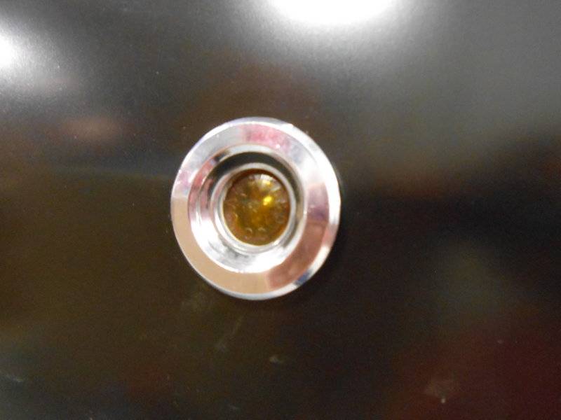

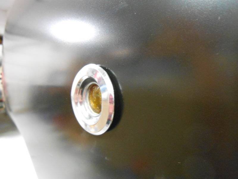

I had the same problems with my AMD front fenders. I didn't think about letting the company know about the marker light hole (good idea). Mine was off 3/4 of an inch or so.I replaced both front fenders with AMD fenders. All replaced panels were AMD
I had only minor problem's with the quarters fitment the floor pan and trunk pans fit great. The wheel houses were not a good fit with out modification. But the front fenders were not user friendly at all. The left side marker hole was not in the right place. But after a small battle the company agreed to pay to have it fixed. The right fender did not line up and I had to hog out the bolt holes a 1/4 of an inch to get the fender forward so I could get the door gap even close.View attachment 843338

I contacted AMD they blew me off. I went to the place I bought them. They took pictures and really mounted them about the sloppy workmanship. So I guess they figured they had to do something. I have used several repop companies and there all the same. Some parts are good most require work. Its a crap shoot at best. But if you cant save your factory stuff its what we do.I had the same problems with my AMD front fenders. I didn't think about letting the company know about the marker light hole (good idea). Mine was off 3/4 of an inch or so.
