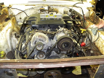

I guess I am going to finally start a build thread on my 68 charger. I wasn’t sure where to put the post. Not a concourse restoration not a restomod either. I had started one under the new modern hemi thread. But after going through installing the 5.7 and 5 speed to me it looked more like a mongrel than a 68 charger. The truck engine is just not a look I wanted. So I pulled it all apart and started the major body work it needed while rethinking the engine.
The history of my car: I purchased it off craigslist sight unseen except for a few pictures about 3 years ago for 7200.00. It was originally a slant six very plain car. 3 speed auto white on white car. It did have a 440 in it and it did run (at least on to my trailer and into the shop)
The engine was date coded 1973. I have a 73 U code out back waiting to be restored with out engine So I wanted to save the 440 for that car. There for the reason to consider the 5.7.
I agree. I am old and old scholl, the modern hemi is great someplaces just maybe not in the 2nd gen Charger!!?

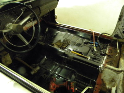

I replaced both front fenders with AMD fenders. All replaced panels were AMD
I had only minor problem's with the quarters fitment the floor pan and trunk pans fit great. The wheel houses were not a good fit with out modification. But the front fenders were not user friendly at all. The left side marker hole was not in the right place. But after a small battle the company agreed to pay to have it fixed. The right fender did not line up and I had to hog out the bolt holes a 1/4 of an inch to get the fender forward so I could get the door gap even close.
Also the taillight panel fit good but the rear valance end caps were a POS! I wound up cutting both in half and welding a small piece in the center to get tem to fit. Just saying this so if anyone comes across this issue just know going in that not all of these parts are a perfect fit.
