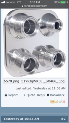

I'm liking one of these!

The one you show in post #1
Thanks 68!
