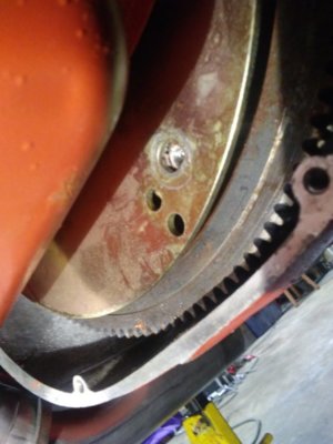

Just removed the 4 torque converter bolts. Still won't turn. With this style of flex plate, i can't really see the crank flange bolts.
