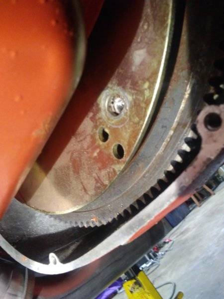

Ok, great. Just worried a major screw up was about to happen. With your 383 being an internally balanced engine, if you had the flex plate with the cut out piece, which is designed for externally balanced engines, you would get a terrible shake when you get the engine fired up. But back to your situation. With the bolts removed you should be able to push the torque converter back into the transmission about 1/2 inch and it should rotate easy by hand. Make sure you mark the point in the picture using spray paint. Reason is because the 4 bolts that attach the torque converter to the flex plate only line up ONE way. One bolt is off set and many people do not know that and may end up with 3 going in and one bold is off. They then force the last bold in. Damage. If you can spin the torque converter now, try and spin engine. If engine still will not more. I have no answer.
