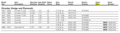

You're not running the 'E' locker are you?
