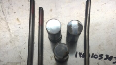

Well that was short lived. I broke the cam in and got it running good. After a while I developed a tick on the passenger side. It eventually started to run rough. I pulled it back down to find 2 ruined lifters and a ruined camshaft. Not sure where to go from here. I verified cam timing multiple times before buttoning it up. I used plenty of assembly lube, as well as a zinc additive. Oil pressure was great, even until the end. All the other lifters look fantastic. I even did a compression check to verify no valve to piston action occurred. Oiling issue? The one with no hole worn in it is locked solid.

I’m sure he will chime in when he gets a chance. He always does. I don’t have a way to check the bore. If you look at my original picture, the lifters is scarred pretty bad, so there may very well be damage. I’ve already invested quite a bit in this engine, so going further with it is getting very hard. Even if it’s a mistake I’ve made causing it.

One of the pics you posted of the old lifters had one that was clearly not turning.

I’ll get the installed height. You are correct, the original cam was not rounded at all. The new cam came with a paste style lube, and I did use it. I would think that if it were break in oil related, all of the other lifters would show the same wear. If you look at the picture, the one with the hole doesn’t even look like the same type of wear as the other.
