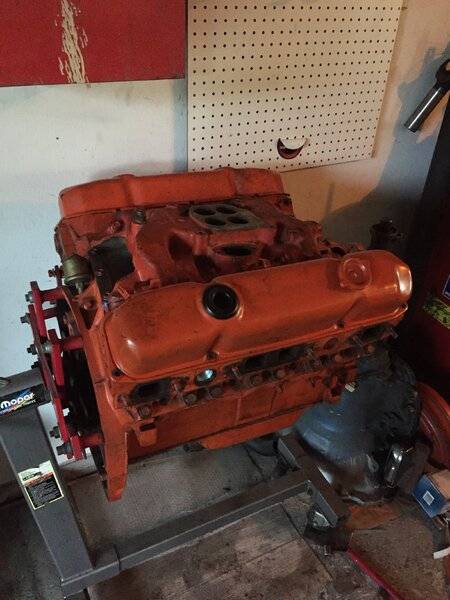

383 spun main?
running cold like a Y block ford which always sludge up
but not with low miles
happens when not running a t- stat but not with low miles
so where did the sludge come from

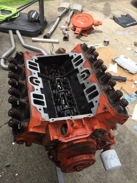

From that pic, it appears the heads have been milled more than just a clean up cut.
If you measure the outer row of head bolt bosses it should give you a good idea of how much.
Stock, the thickness is a nominal 1.00”
I’d pull the valves out of offending positions...... see if there is adequate lube in the guides.
Agreed on the big mill job. Not sure I’d disassemble though. Thinking it’s a way to find sticky valve guides? Looks too clean for that.
I will probably be changing the valve springs for the new cam anyways, so I can look at everything while I’m there.
The head is off and on the bench, and you wouldn’t spend 5-10mins to pull the valves out and have a look?
I know I would.
The heads have obviously been thru the machine shop.
Who knows what’s been done, and/or if any of what was done...... was done properly.
Now is the time to have a look.
I'd hand lap them just to check seats. Some say it's a waste of time. I'd do both heads, do it once and do it right. Is sludge all over or just in the pan?
The valley looks clean.
My concern would be poorly done guide work...... with possibly inadequate clearance.
If you pull the head apart, you can see exactly what’s been done and how things are holding up.
Both heads are coming off. Sludge was only present in the pan, but did find a little in bottom of the lifters.
I measured the thickness at the bosses and they are at 1.00” if not a hair over on average.

I guess those heads weren’t cut very much afterall.
if you need a coating Hylomar spray works even on the old red gaskets
good news on the heads being cut
