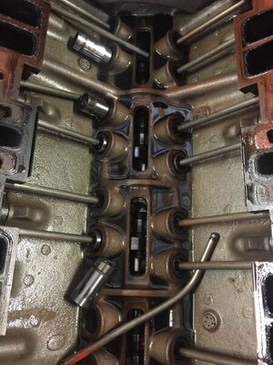

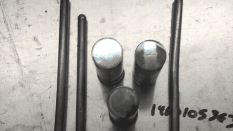

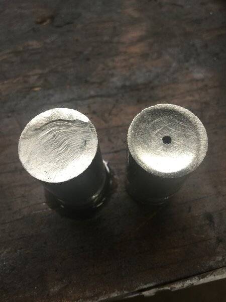

Well that was short lived. I broke the cam in and got it running good. After a while I developed a tick on the passenger side. It eventually started to run rough. I pulled it back down to find 2 ruined lifters and a ruined camshaft. Not sure where to go from here. I verified cam timing multiple times before buttoning it up. I used plenty of assembly lube, as well as a zinc additive. Oil pressure was great, even until the end. All the other lifters look fantastic. I even did a compression check to verify no valve to piston action occurred. Oiling issue? The one with no hole worn in it is locked solid.
Same ones?
New lifters, same locations. 2 and 8. I would think if it were related, the first two lifters would have visual damage on the bottom. Valves move freely and push rods are all perfect.

I'd be looking at the 2 lifter bores. maybe egg shape so lifters are cocked some how. Mopar blocks are dam good, but those lifter bores? When said 2 & 8 was that what cylinders they worked or what
Yes, they worked for cylinder 2 and 8. The bores “look” fine.
I'm hoping PRheads or an engine builder would comment. The bores are in main oil gallery. If you put a lifter in if cam is still in engine and a see if you can slip a .002 or a .003 feeler gauge in? Better if you have a way to measure the lifter bore.
I’m sure he will chime in when he gets a chance. He always does. I don’t have a way to check the bore. If you look at my original picture, the lifters is scarred pretty bad, so there may very well be damage. I’ve already invested quite a bit in this engine, so going further with it is getting very hard. Even if it’s a mistake I’ve made causing it.
If your cam in engine put a lifter wiggle around and compare it to others. PRH gave some good advice.

One of the pics you posted of the old lifters had one that was clearly not turning.
That would have been the first thing I checked with the new cam & lifters.

I’ll get the installed height. You are correct, the original cam was not rounded at all. The new cam came with a paste style lube, and I did use it. I would think that if it were break in oil related, all of the other lifters would show the same wear. If you look at the picture, the one with the hole doesn’t even look like the same type of wear as the other.
