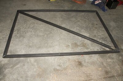

I decided to use 1/8, 1 1/2 steel tubing. I'm not sure the "x" pattern is ideal for this application but like the idea. It has created some challenges for a door that opens on the front. This door measures 4'w x 6'l.

If you'd built the door with uprights instead of that X brace then putting in the hinge and lock supports would have been a breeze.
Mounting the hinges would have been a big pain either way from what I experienced with fitting and clearances. The "x" keeps it lighter. Uprights still don't solve the problem of multiple horizontal bolt holes. I like the problem solving and then pissing and moaning about it. :-)
I can weld so makes no difference to me about fabricating stuff. Thanks for the support!
